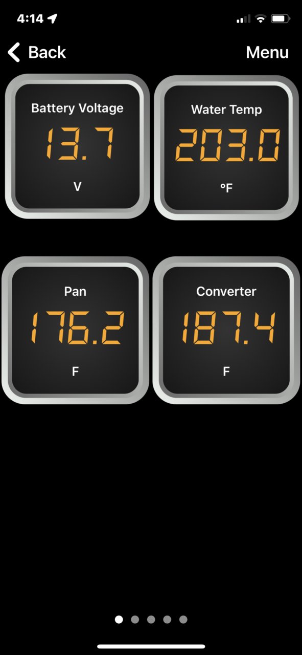

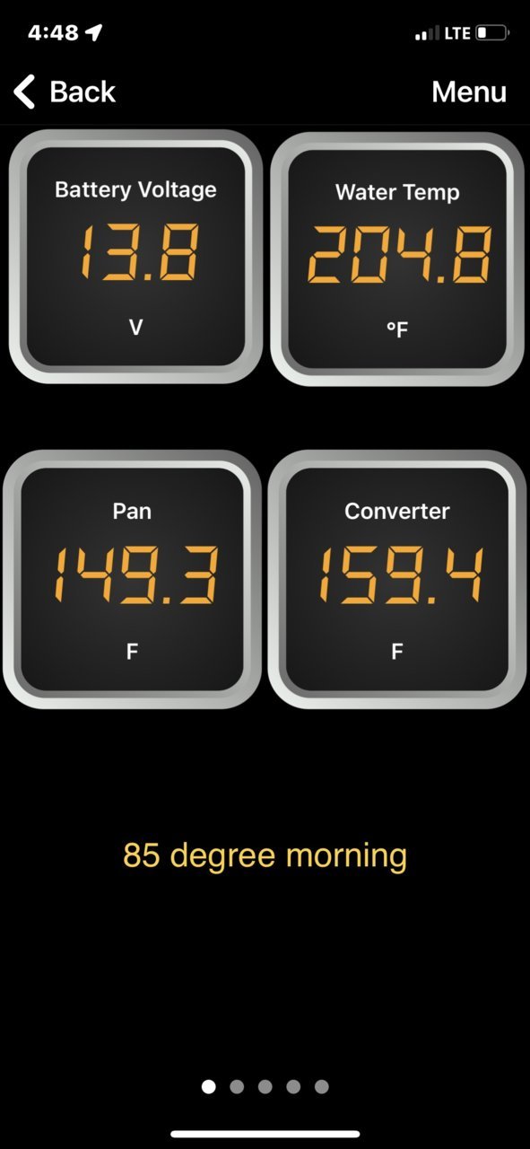

    Here is todays drive with the billet thermostat housing running the 180. Morning drive 85 degreesIMG_3028.jpg
    Today on the way home. 110 degrees.
    jamesepoop and Torspd like this.

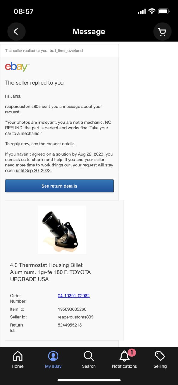

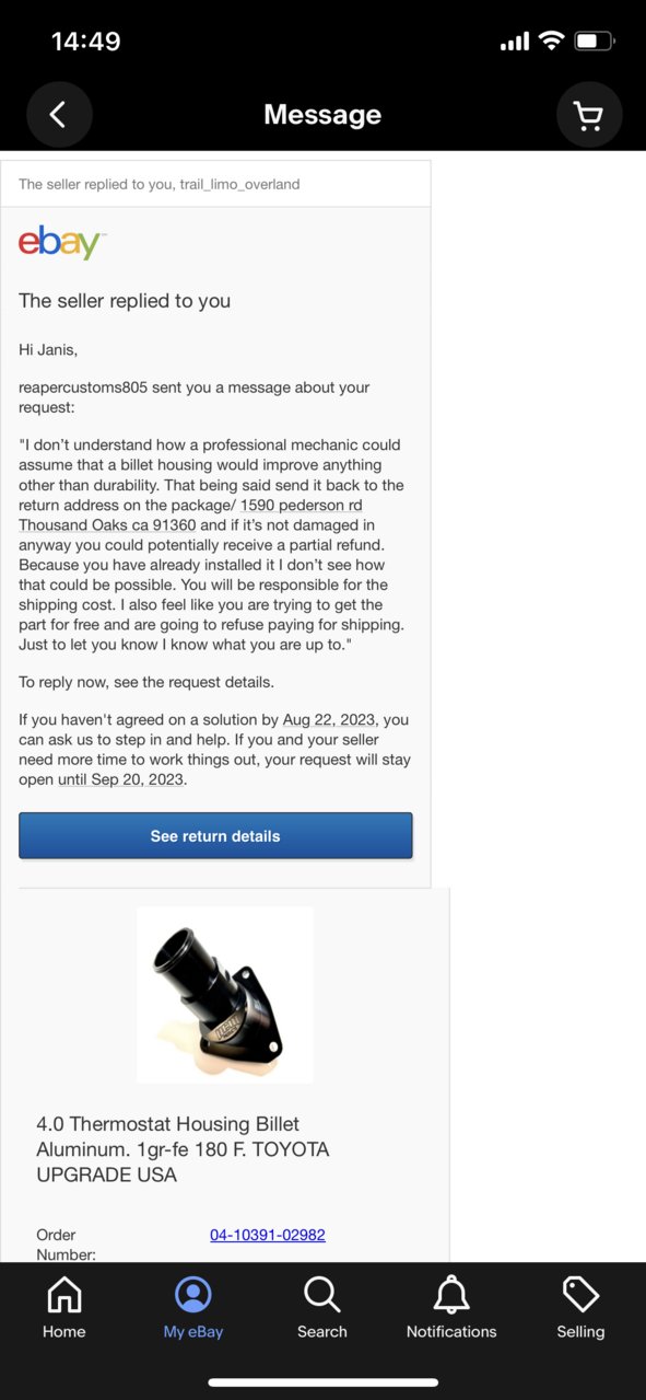

    I wouldn’t waste your money on this. And the seller is a total prick.
    Rob MacRuger and garciav like this.

    @1GR-FE<3R how are you addressing these real world issues? You seemed to be happy to take the money but no real support when it comes to post sale.
    Rob MacRuger likes this.

    Yeah, don't. I am now dealing with returning this, otherwise it will be a pretty paperweight.

    Stellar seller. Accusing me on wanting this paperweight for free when I’m trying to return this because of the printed claims on black and white are not the reality promised. Lol what a clown.
