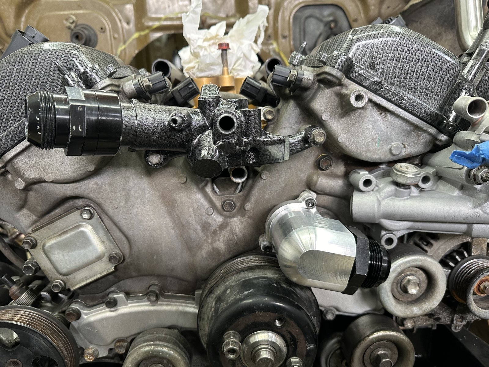

    Man, you need a build thread. Looks like a fun project.

    Did you make changes to the thermostat bypass circuit.

    Not really there will be 2 lines taped to the billet housing 1 for the rear circuit and one for the oil cooler.

    If you simply removed the oem thermostat, and did not sort out blocking the bypass ports, coolant flow thru the radiator will be substantially reduced. The bypass circuit is a temp controlled means of more quickly warming up the engine, and then as temp increases, ensures proper flow thru the radiator.

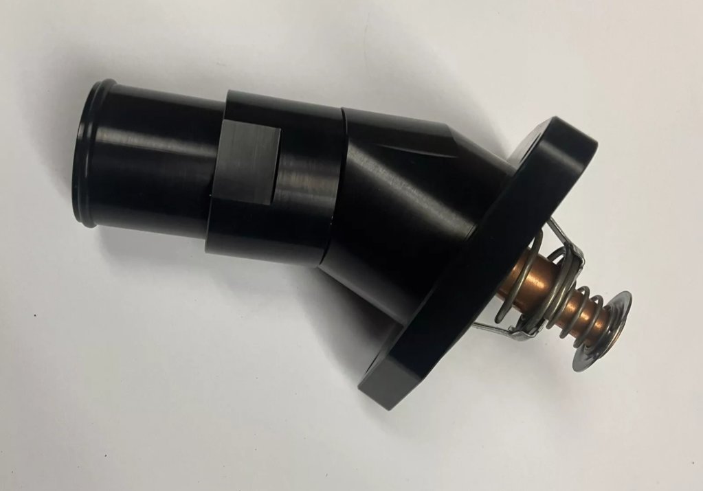

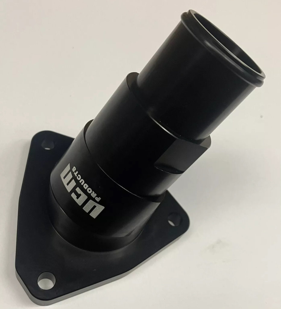

    2nd gen housings are now available! We are trying to find someone with the Magnuson/TRD supercharger to confirm that it clears the belt.
