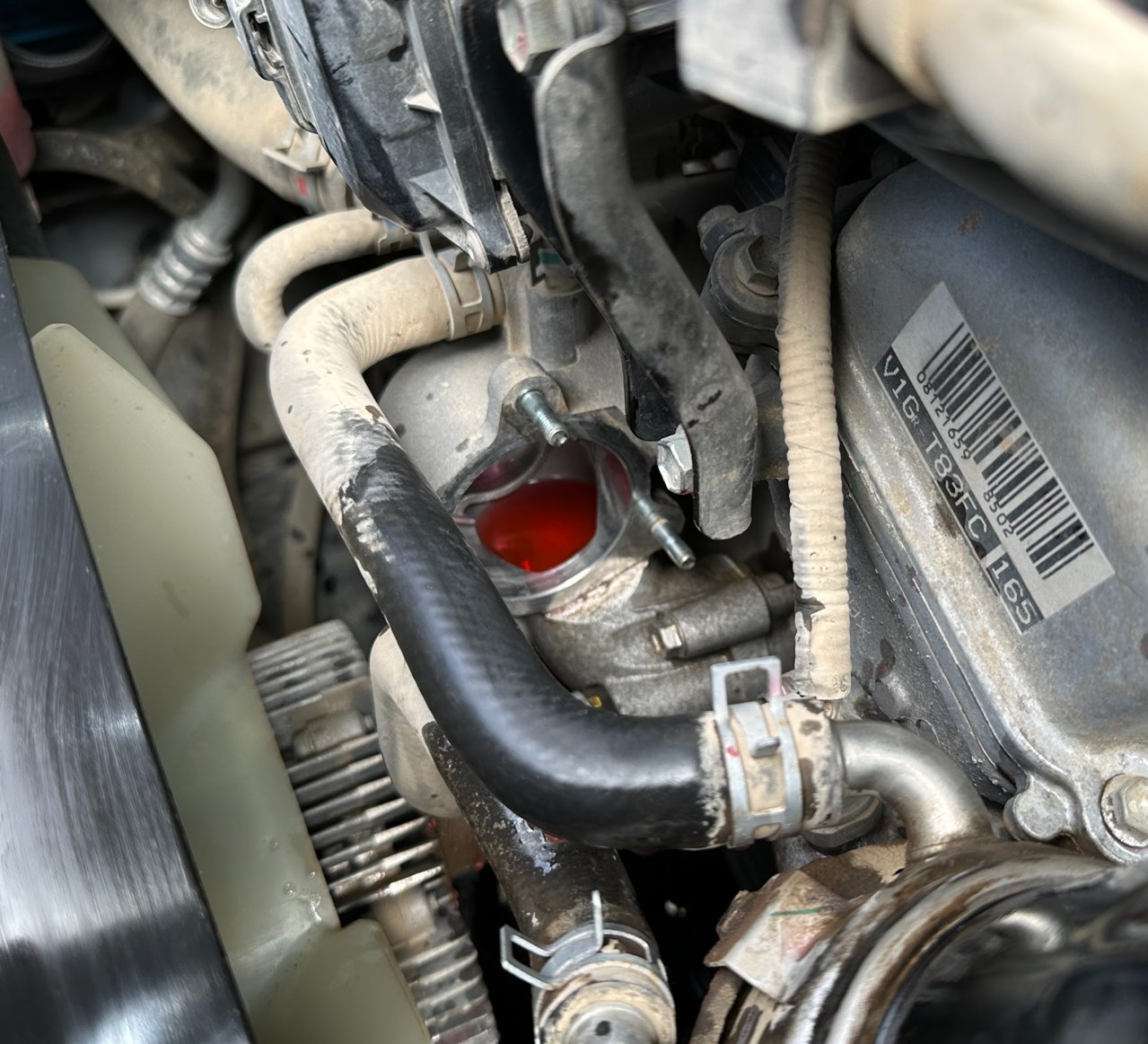

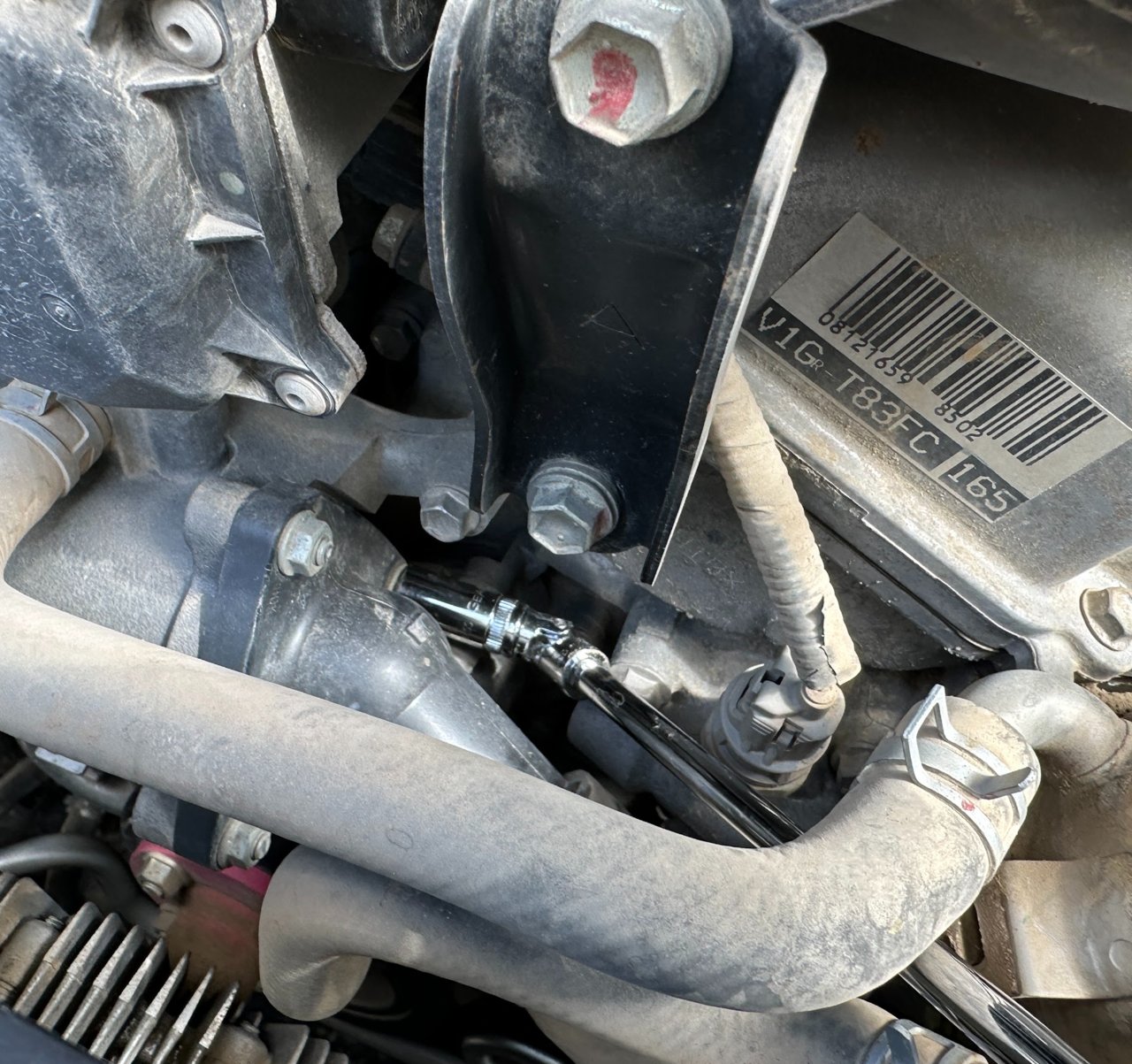

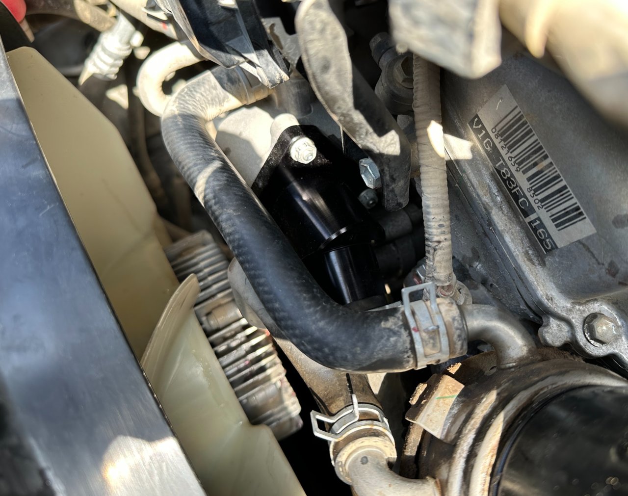

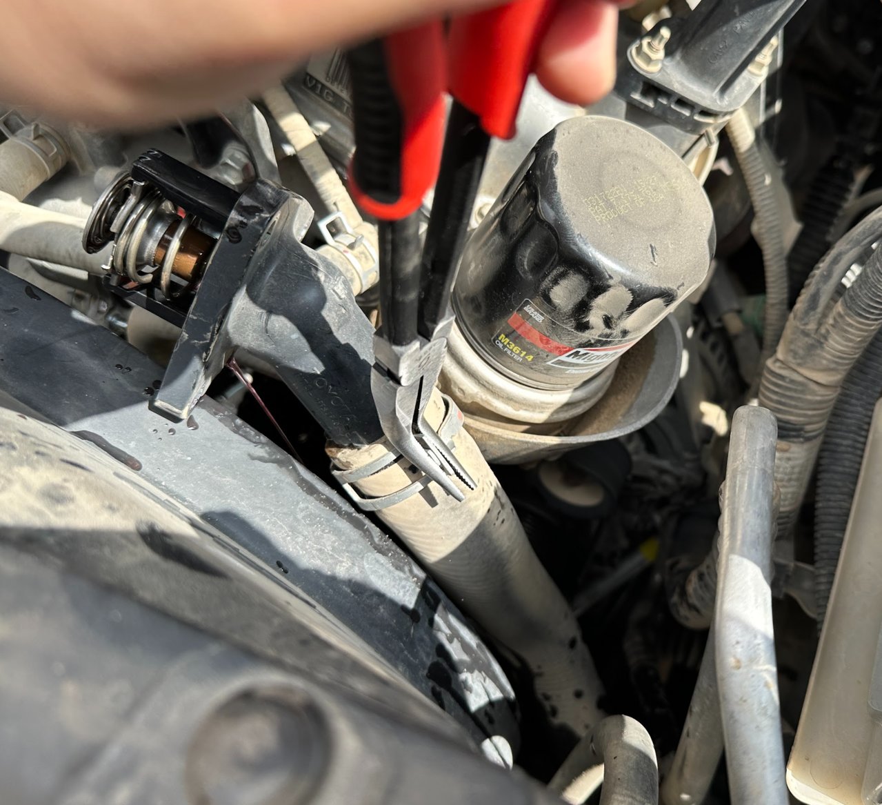

    I put mine on this weekend. Took about 20min because I was taking my time.
    Extension and universal swivel helps to get to the back bolt.
    You'll lose about a quart of coolant.
    I put a light coat of Permatex 22071 Water Pump and Thermostat sealant on the gasket for good measure
    Extension with universal:

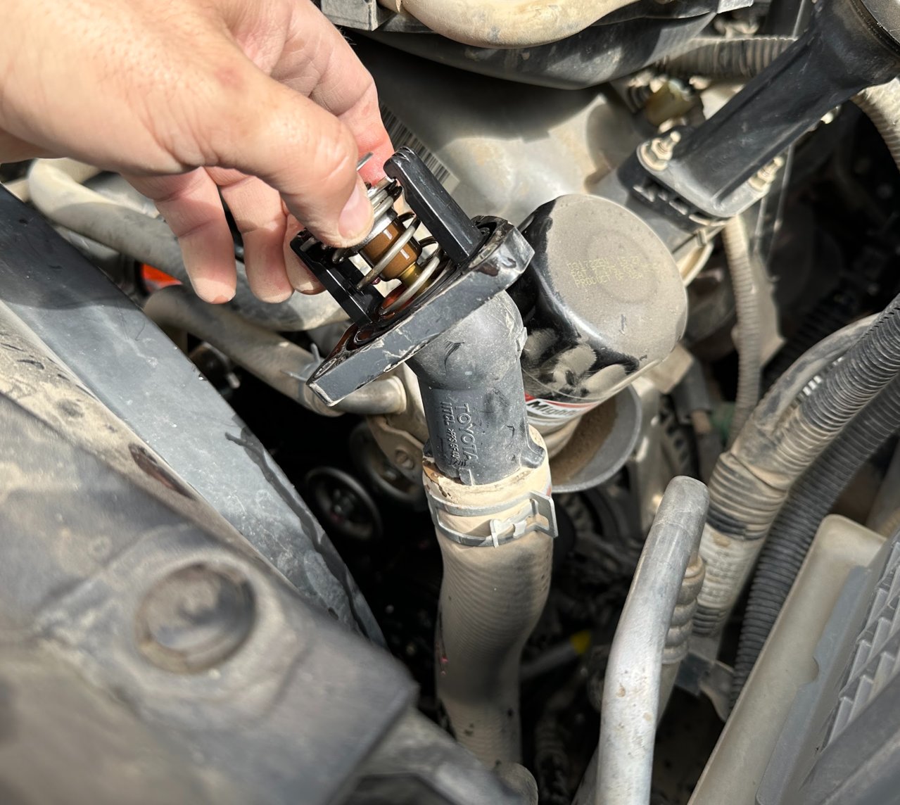

    Pull the thermostat/hose under the oil filter lines, towards the battery to get to the squeeze clamp easier:
    I used these long angled needle nose to get the clamp off and back on. The factory housing needed a bit of persuasion to release from the hose but it wasn't too bad.

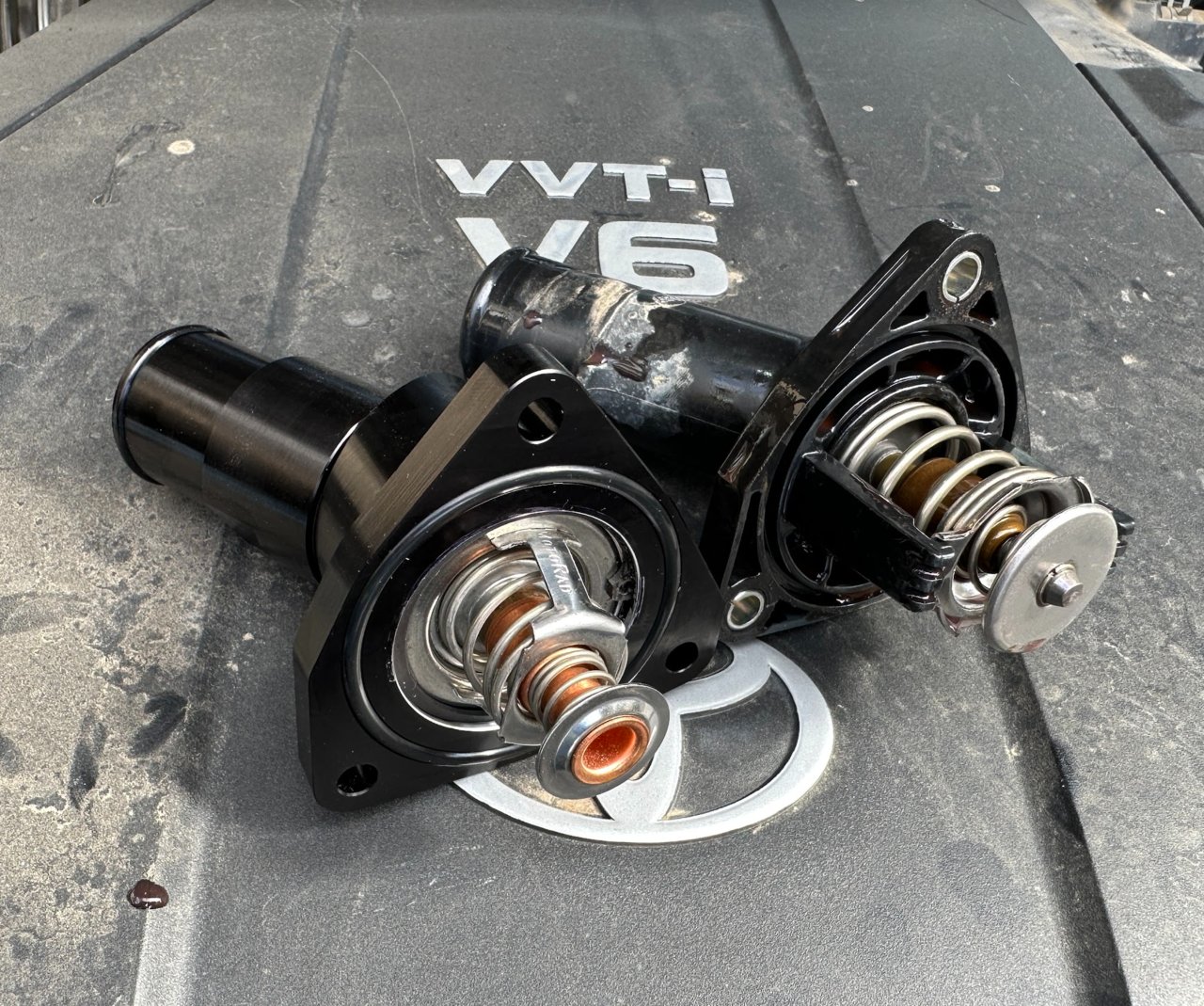

    Factory vs UCM
    Make sure to remove the factory rubber gasket from the inlet. then clean the surface from any dirt/grime.
    Factory torque spec is 80 in. *lbf that's INCH not FOOT, or 9.0 N*m
    -Chris

    Awesome. So you didn’t drain the radiator?
    1GR-FE<3R[OP] likes this.

    No need to completely drain the system! Especially if you leave the radiator cap on, it creates a vacuum on the system and does not allow the coolant to flow out freely. When replacing thermostat very little coolant is actually lost!

    No, our (2nd Gen) housing is pretty high up so you don't "need" to drain it to change the thermostat housing. My fluid still tests as good with test strips so I decided not to drain.
