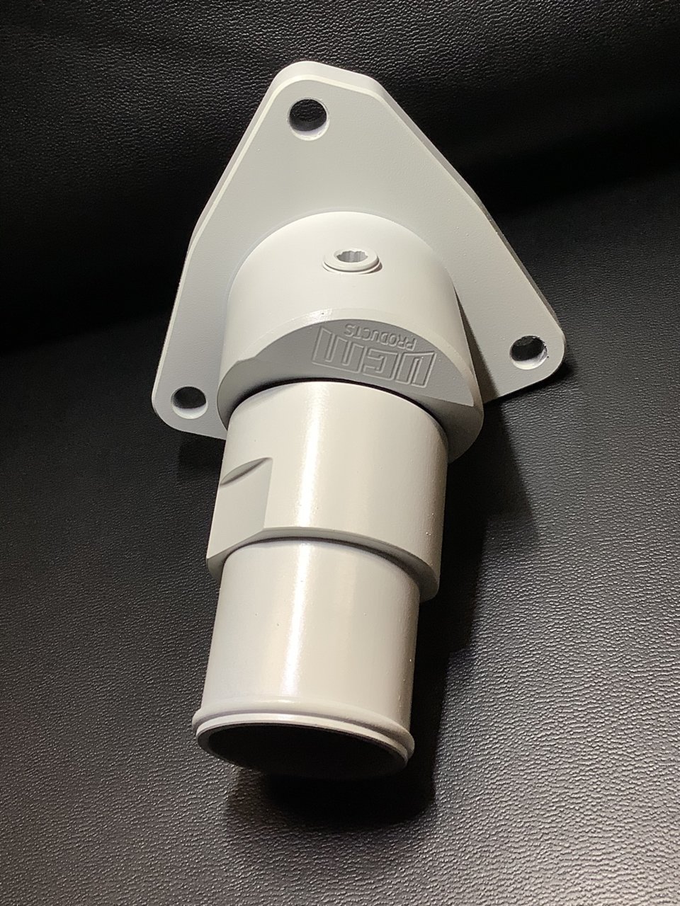

    Got my T-Stat in the mail the other day. Awesome design @1GR-FE<3R and beautiful machine work by Unleashed Customs. :thumbsup: I had to look it over in detail and admire it as a fellow programmer/machinist.

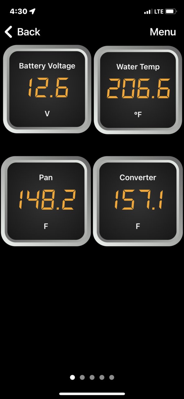

    D0F8F26F-7199-429B-98DE-9FF6226BF565.jpg On my way home from work. 80 degree day. 180 high flow installed.

    So about the same?

    Looks a little warm to me. Do you normally see water temps above 200?

    Seems like it.

    Yes. Needle sits in the middle of the gauge. On the highway upper 190’s.
