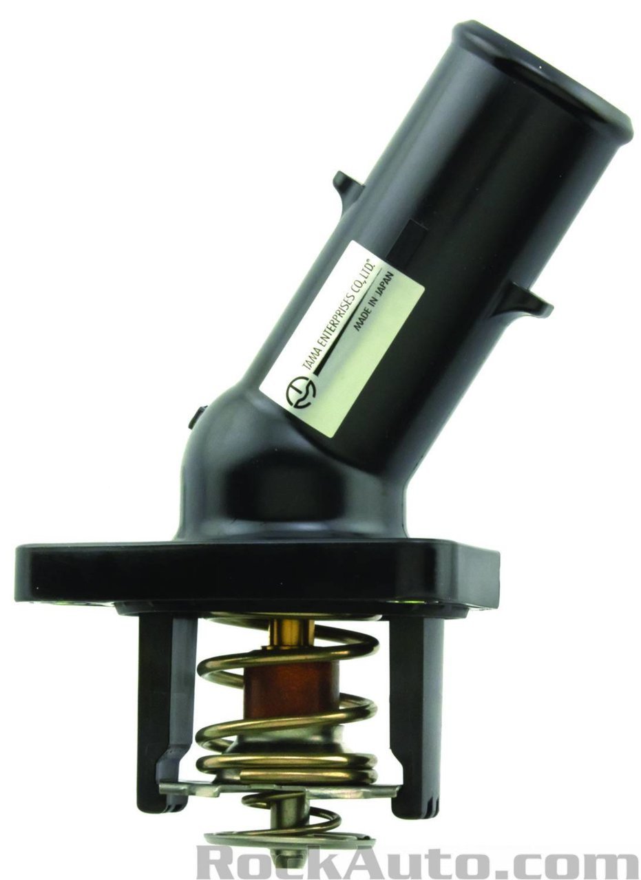

    Is there a difference with the housing if you have the towing package? Rock Auto has a housing with and without the towing package.

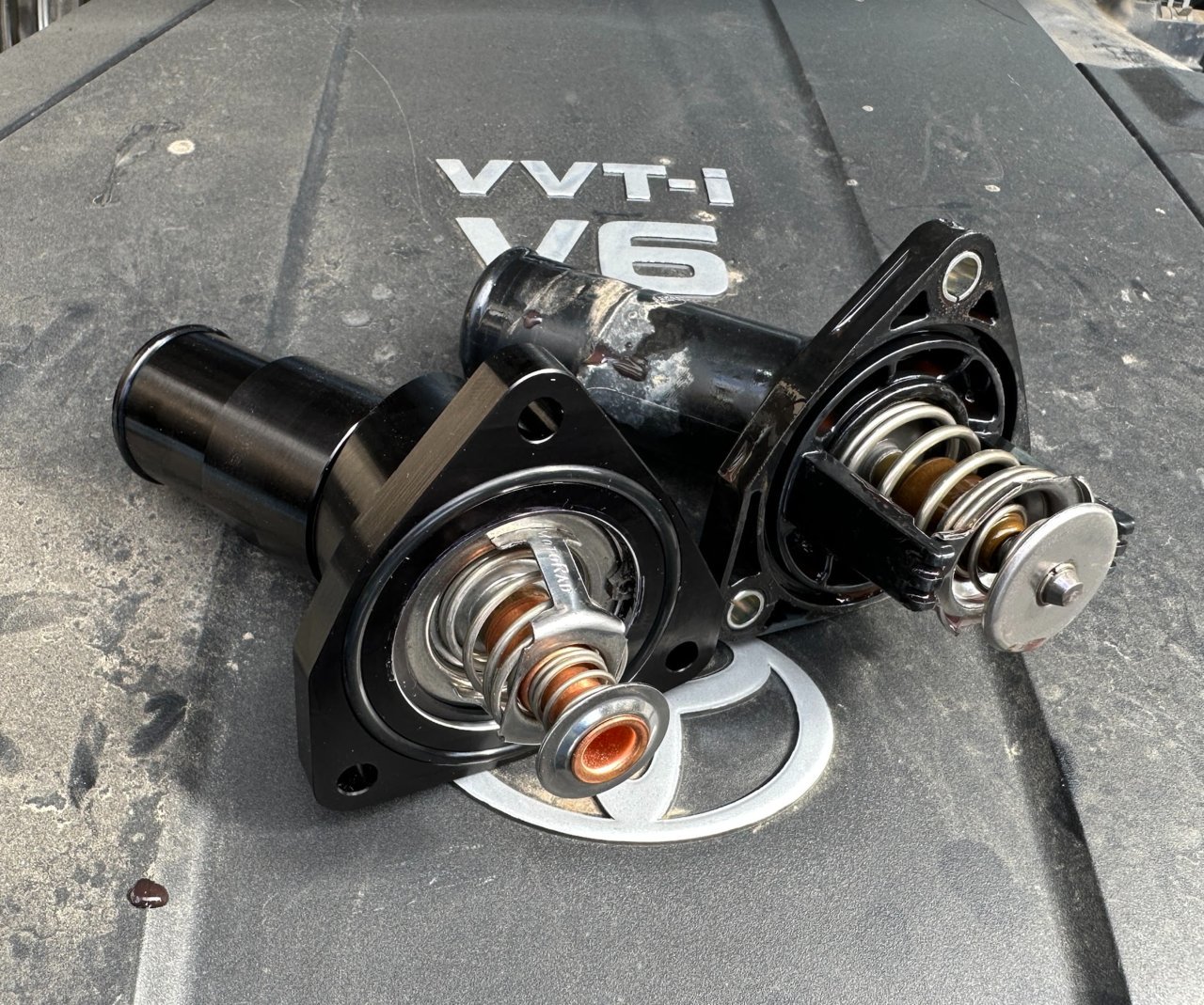

    1FBD1ECB-E9BD-46D6-AEB8-6A5E934913DB.jpg Finally had time to research why my engine ran hotter and with fluctuating temps when the billet housing and Motorad high flow 180*f thermostat is installed (actually tried two thermostats with the same results).
    These 1GR engines utilize a Double Valve type thermostat as oem. The disc diameter at the end of the thermostat is important, as is the discs location and travel when going from cold to 180*f.
    Explaining, when the engine is cold, the actual thermostat is closed, and the disc has the water bypass port uncovered. This allows the engine to warm up quickly by recirculating coolant without sending any to the radiator.
    As the engine temp gets to 180*f, the thermostat opens while at the same time closing off the bypass port. This allows water to flow from the engine to the radiator, and back to the engine.
    If the bypass port is not capable to be closed, heated coolant circulates back thru the engine without being cooled in the radiator.
    The oem thermostat has a much larger disc to block flow as needed, sending coolant to the radiator. The Motorad thermostat had a smaller diameter disc and is not capable to block the flow as needed.
    This explains why my truck ran temps that were fine at idle, yet as rpm and load increased, the temps ran 10*f hotter than the oem thermostat at 60 mph cruise on flat highway. Simply, a portion of the engines heated coolant was being recirculated back into the water pump / engine without passing thru the radiator.
    Reinstalling the oem plastic housing and thermostat restored the temps as they were.
    Note in the photo, the difference between the two Double Valve thermostats. The Motorad has the smaller disc on the end, while oem has the larger disc, capable of correctly controlling heated water flow in the system.
    All the best to those using this well machined part. Mine sits removed and on the workbench. Not worth having localized overheating within the engine.
