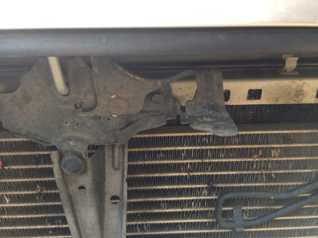

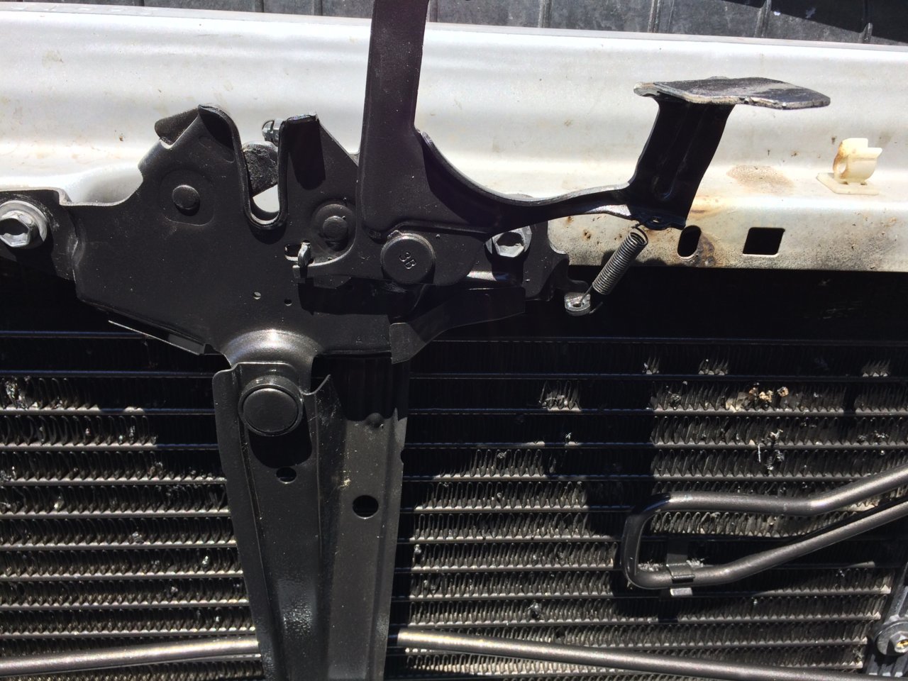

    just drill and bolt? looks a lot easier than having to remove it, heat it up, and reshape it in a vice.

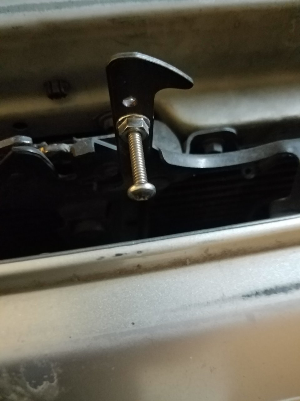

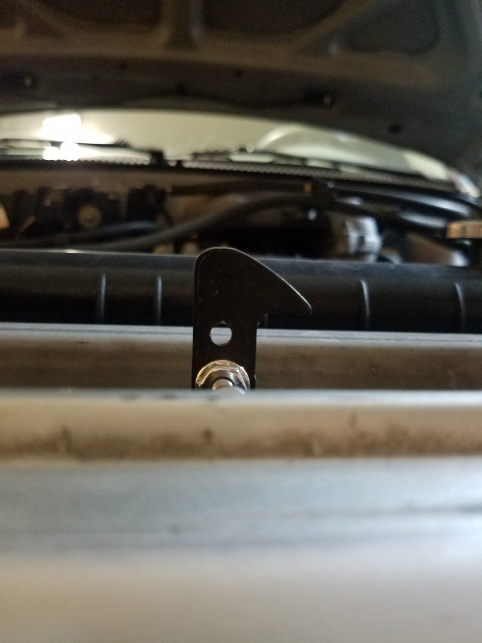

    I just added a 2 inch #10 machine screw to the latch. I'll post a pic.

    My left hand is partially paralyzed. This allows me to open with one hand.
