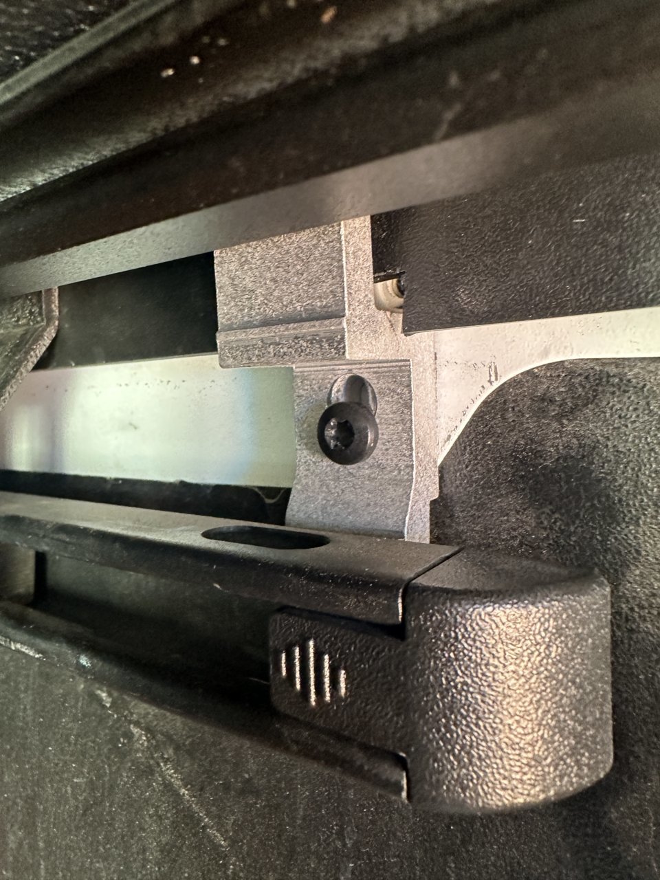

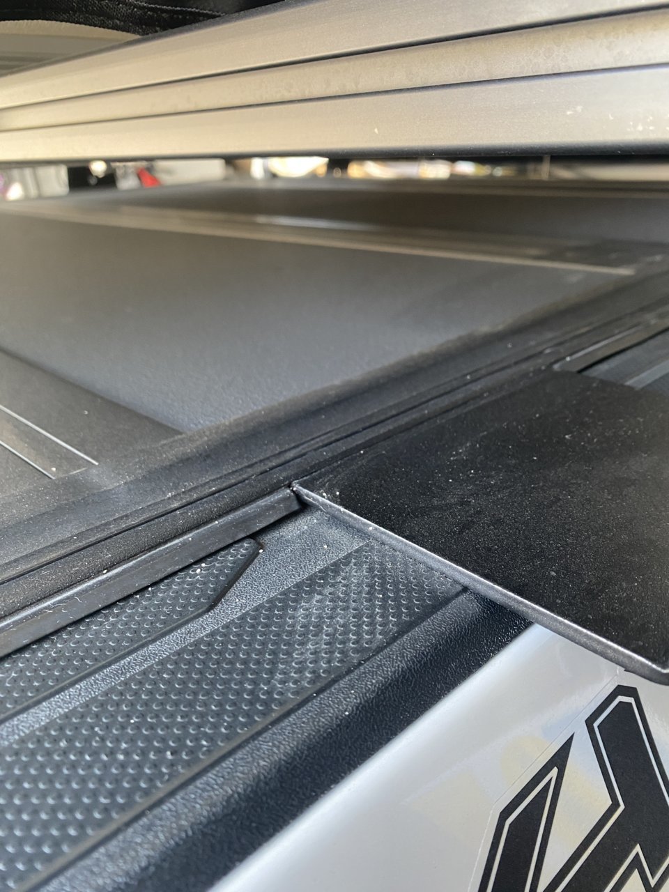

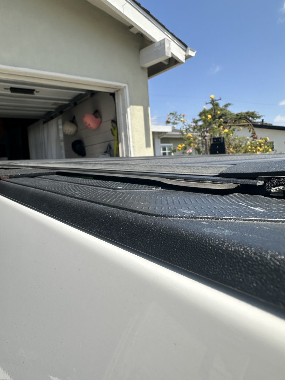

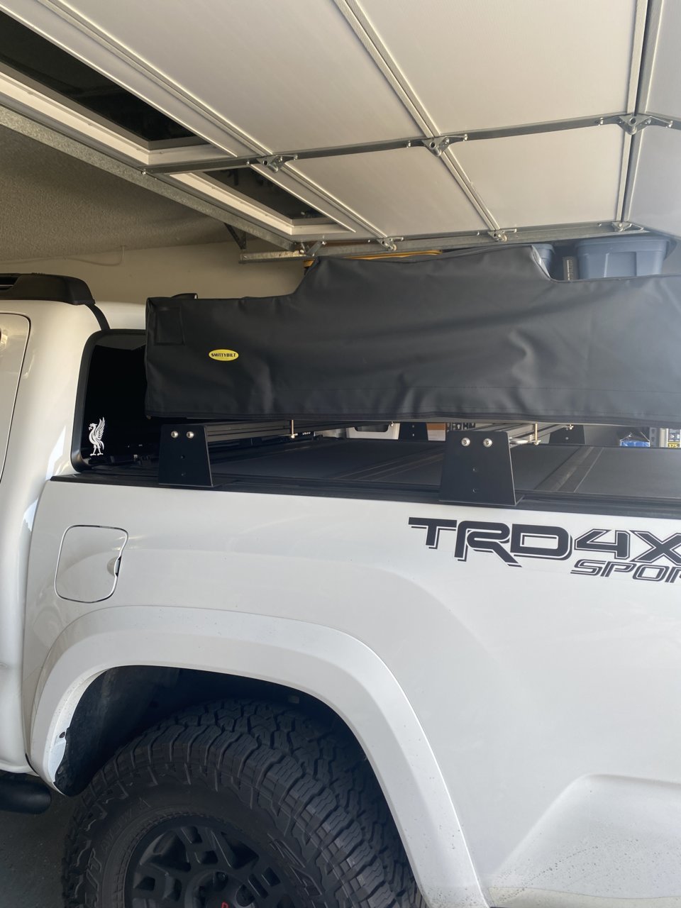

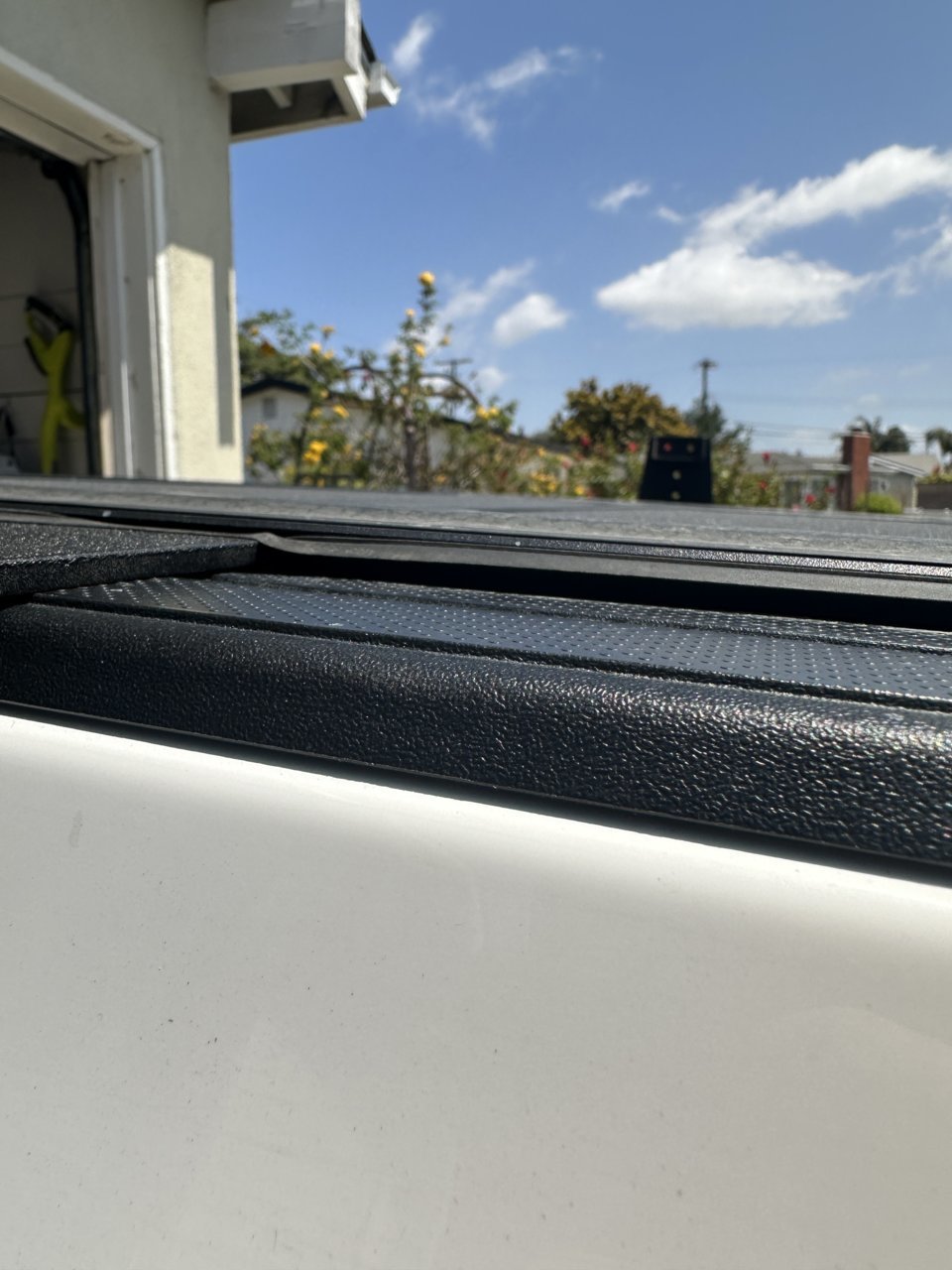

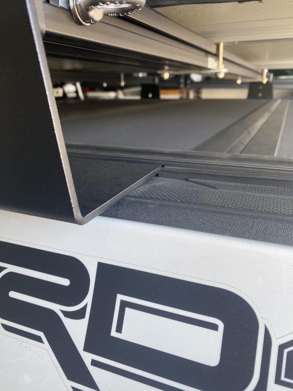

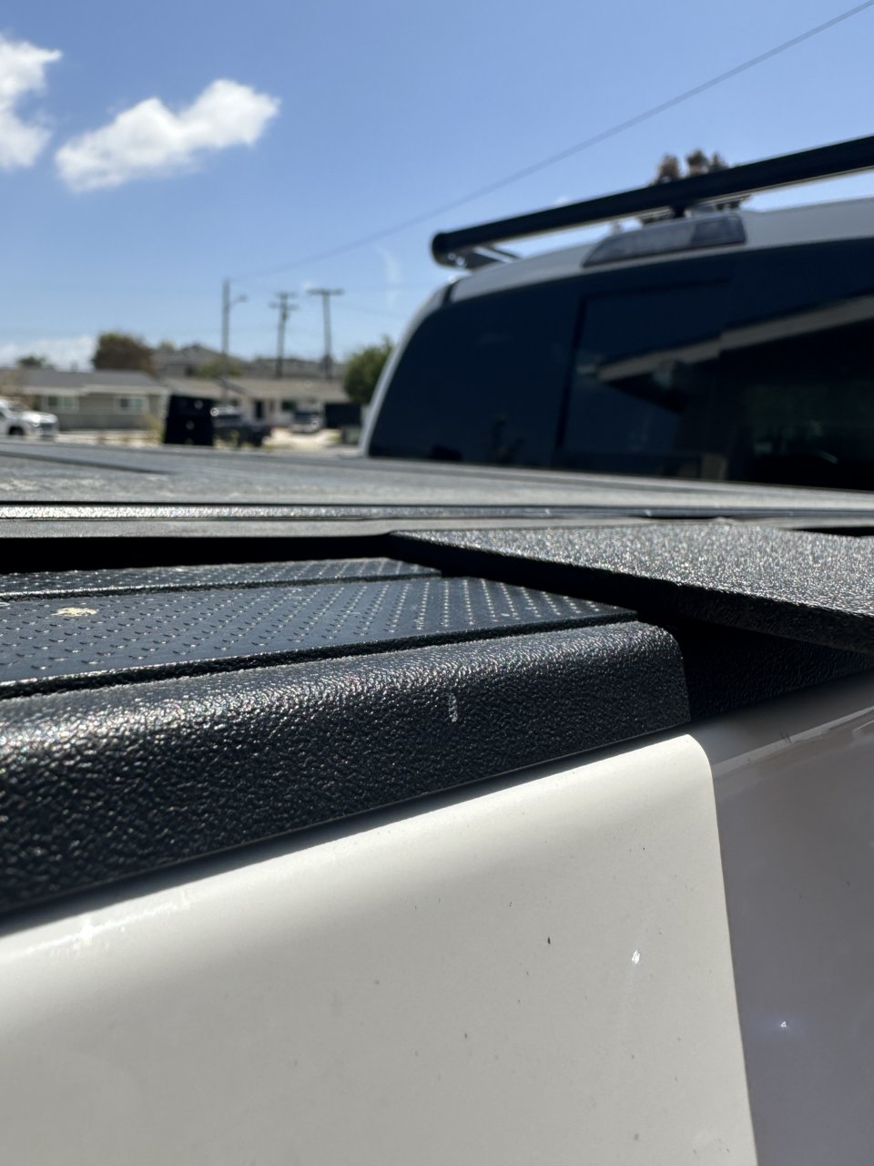

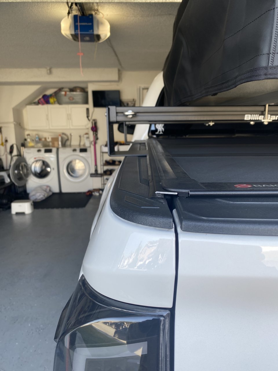

    Here are some pictures from my install today.
    I opted to cut into the plastic on the bed side near the silver brackets used to relocate the utility rail. Without cutting the rubber seal on the bakflip there is definitely a small gap for me. I'm going to see how bad the water leakage is before cutting the bakflip seal or adding foam.
