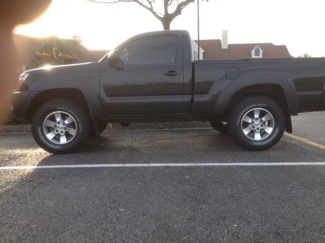

    2013 4x4 reg cab Auto
    2013 4x4 reg cab, 2011 4runner sr5 rims, 265 general grabber at2's, 5100's All 4 corners with fronts at .85, De badged, Egr Rainguards, Led tail lights, Int wipers, fog lights, Trailer Hitch, POwer locks+ keyless entry, Extang Solidfold Bed Cover, WeatherTech Mats, Stubbie Antenna, Trd Skid Plate, Tint, Scanguage, Cargo net in bed, Sound Ordnance B-8PT, FULID FILM Under Coat.
    my vote is for 1.75 of you don't plan on doing anything for the rear.
    1.75 makes my reg cab level sure it will make the dbl cab sit little lower since its heavier

    no problem glad i can help, i think 1.75 is best setting, 1.5 dosent loook level and 2.5 is way too high

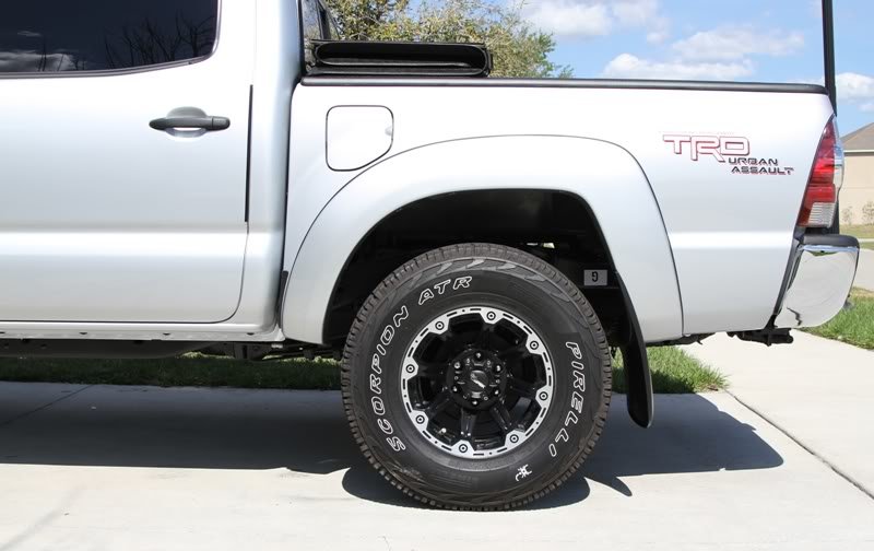

    Would you be able to take a center hub to fender rear measurement?
    Just curious because the truck I just purchased has a 4 pack in the rear. My 2008 went from a 3 pack to 4 after I had the TSB done...
