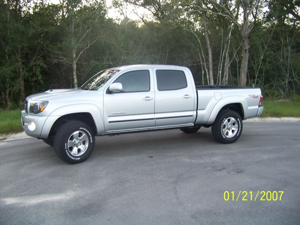

    should be getting them tomorow front and rears . have the rear tsb setting the front at 1.75 should that be level ? and with the front set at 1.75 any suggestions on tire size ? should be picking up tires this weekend want the biggest i can go with no problems i know i can do 265/70/17 on stock hieght no problems but what with the slight lift thanks

    ^^^ In the above pic,TSB leaf pack..Billys set at 1.75.Parked on a slight up hill.The tires are 265-70/17 AT's on stock TRD sport rims.
    The next size Taller (32" even) you can use/run is 255-75/17. This would work on stock rims.

    Have the tsb rear springs & billies @ 1.75", The truck still sits just a hair higher in thre rear.

    with the 1.75, you can fit 275/70/17 on factory rims with no trimming. bfg just started making this size. like a month ago. that is what i am going to put on my truck.
