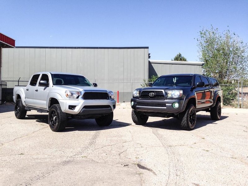

    First off, hello tacomaworld.
    A buddy and myself did this last week. Was amazed at how well it worked. Did my '11 and his '12 in about 6 hours. Including rear aal and shocks.
    OME 885x and 5100's all around. Didn't need to remove sway bar. All in all safe and quick. Thanks to the OP.

    Looks good!
