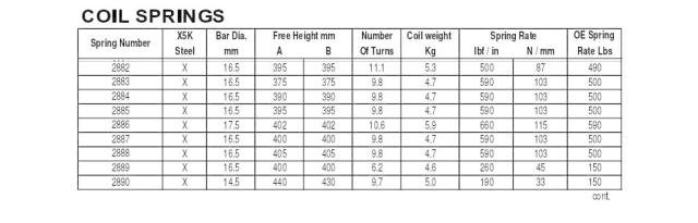

    883,884,885 and 887s all have the same spring rate - 590
    886 springs are 660

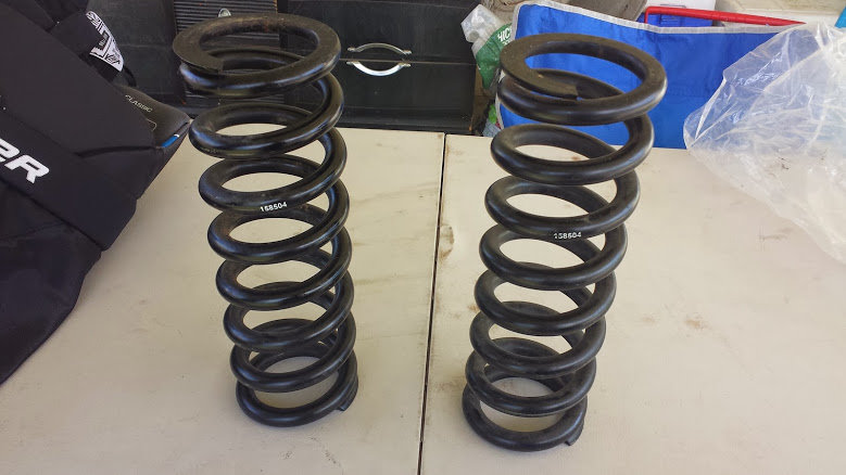

    I have question for you guys??? would a 5100's fit a icon 158504 springs??
    158504
    13 inch length
    650 lbs
    3 in around

    ^Probably not, because the Icon spring ends are closed and ground flat, while the 5100 perch is slanted to accommodate OEM spring ends. Attempting to use the Icon spring will likely cause either the shock or the spring coil to fail in bending.
    The new Bilstein 6112 60mm shock might be able to accept Icon springs, but I haven't seen anyone try it.
