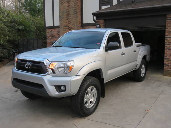

    Here's mine just as a contrast rear TSB springs fronts set to .85 5100's all four corners with 265/75/16's love the ride and so glad I ditched the Dunflops.

    thanks for sharing the pics! Look great... so do you have the front rake? Any rubbing from the tires?

    Yes just a touch of rake, I could have gotten away with 1.75 but held back. No rubbing at all lock to lock. The tires are Hankook RF10 At's, also the spedo is now dead on accourding to my Garmin.
