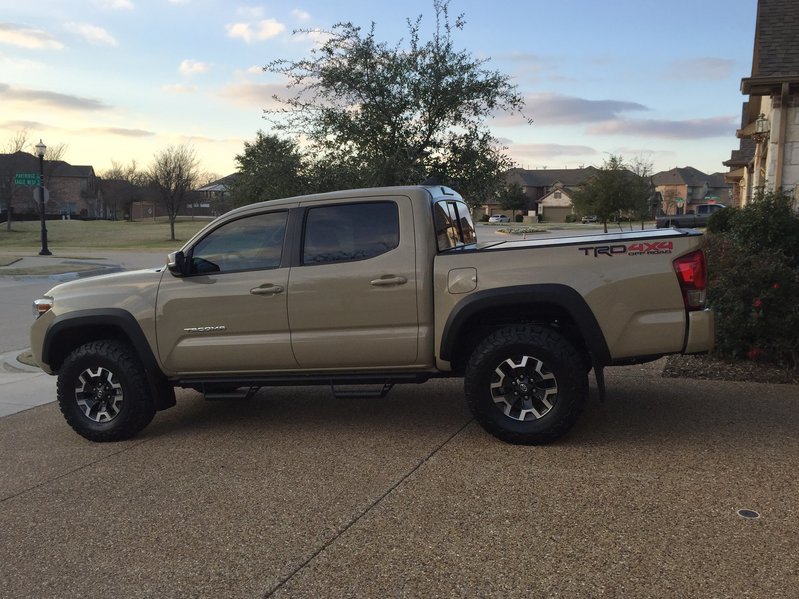

    image.jpg Bad pic since I am on a down slope, but I have BFG KO2's (265-75-16) and bilstein 5100's on all 4 corners with the front set a .85

    The factory springs have different specs to account for the lean, and it's really more of a problem for aftermarket springs like the kit you linked.

    Nothing in the rear? It seems raising the front has a little impact on the rear as well.

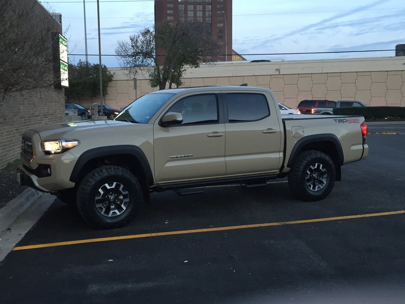

    Here is a little better picture

    Just 5100's all around which only raises the front not the rear.

    I understand, but it seems like raising the front only gives a slightly larger space between the rear wheel and fender; using the rear as the pivot, it rotates up just slightly or appears to be an increase due to the fender angles.

    Looks good.
    I've had 5100s on my 04 for years and loved them, I might have to get a set for the new truck too.

    Good looking truck!
