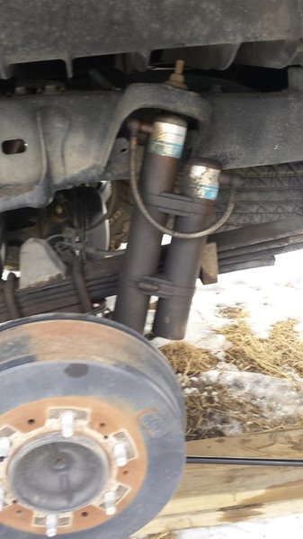

    For anyone going with 5160s in the rear and live in harsher winter climates, I reccommed they apply a clear sealer of some kind to thr outter shell and maintain the hoses and joints with a bit of grease to help prevent the surface rust that appeared on mine before you install.
    Not only did it look like shit shortly after install (6 months)- I think it led to failure just 3 years (and 40, 000 km) after installation. I had a blow out at the seal and joint on the left side. I can't be 100% positive that's what led to the blowout- but the joint was almost seized and had a ton of debris around it.
    I was in contact with a Bilstein rep via email when I was looking for replacment and asked her if the product they were now producing adressed this issue- as I read on here and other forums that people were experiencing a similar issue, and all she did was re curgitate the fact that it's probably due to environmental conditions. Well no shit but you should design your hardware to stand up to the elements. Who wants to baby hardware on a truck! ? Total BS IMO especially if your vehicle was regularly washed like mine.

    Well I guess I know what kind of shocks to not buy for driving around here in Michigan ... :/
