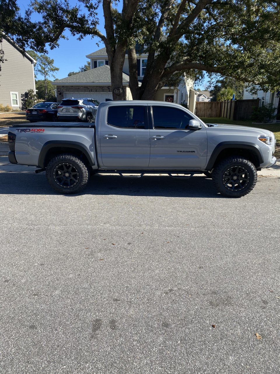

    How did this work out for you? I put 5100s on @1.65 clip setting with the stock springs. Ended up getting 1.75. Was thinking it would settle .5 but I guess everyone saying that changed the springs as well. Been a few weeks. It looks OK but a half inch in the back might be a little better. I could also go down to the 1.1” clip setting but kinda like the height.
    Did you notice any difference in the ride when putting in the shim in the rear?
