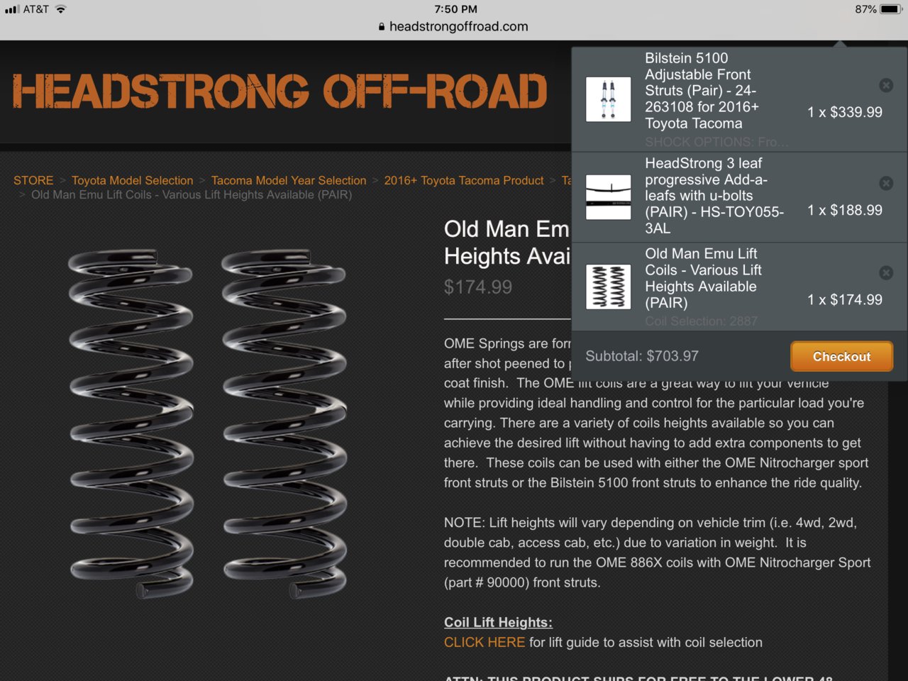

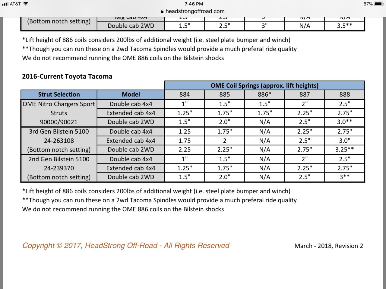

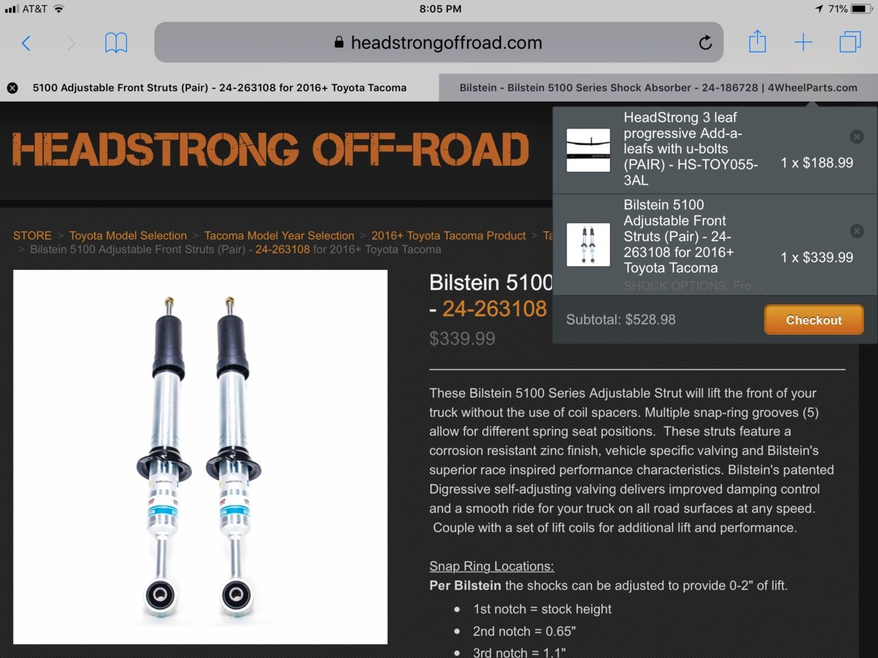

    765FCE76-2553-48D5-90C2-7432D5B2644F.jpg 191E3004-8544-496B-AD34-8BD57745748D.jpg
    Look at https://www.headstrongoffroad.com/
    You can buy 5100s for the front and rear, use the stock front coils and use the HS AAL for under $530
    This is what I’m leaning towards...BUT
    You can use OME 887 springs for another $175
    If I use stock springs then the front 5100s will be set to the top notch for 2”of lift
    If I use OME 887 springs the front 5100s will be set at bottom notch
    justinlj93[OP] and kgilly like this.

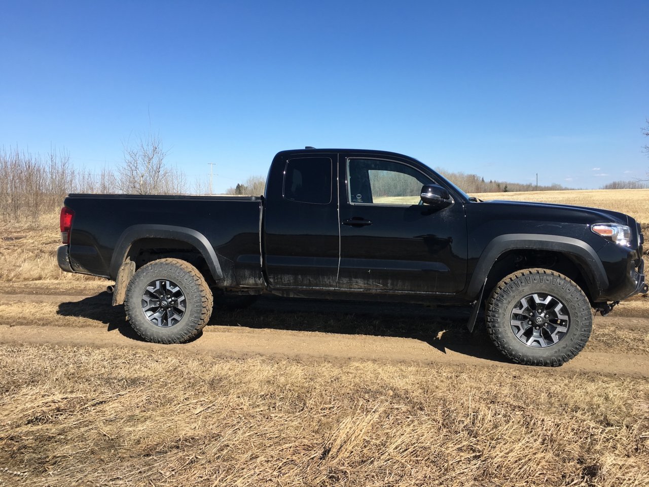

    02 Taco RCSB, 16 Taco AC6MT, 07 FJC, 22 Bronco
    5100s all around, 887s, 3 leaf AAL w/ overload removed, 265/75/16 with Spidertrax spacers.
  13. May 2, 2018 at 7:15 PM
    dagsamp
    dagsamp Unknown Member
    Apr 18, 2018
    #250978
    207
    Marla
    16' TRDOR DCSB OV Tune
    OV Tune
    Looks good! Do you enjoy the ride? I plan on doing the exact same set up except maybe MD Dakars. 1.25 spacers?

    Lift with coil springs not struts! Preloading the stock springs by setting the 5100s on the top notch will make the ride rough.

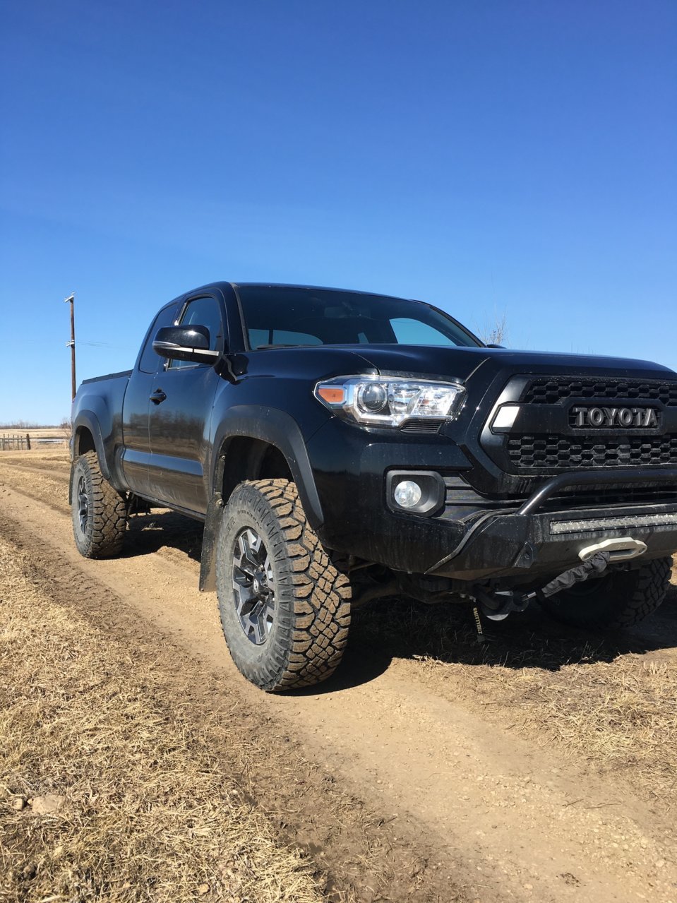

    5100s Wildpeaks Light bar Other shit
    Axel wrap is seen more when you run blocks over an inch or so, so in your case might as well just go AAL since you’re looking for 1.5
  18. May 3, 2018 at 3:34 AM
    #18
    MOC221_
    MOC221_ 3 pedal metal
    Feb 20, 2016
    #178858
    7,850
    Frank
    2019 DCSB Sport M/T Barcelona Red
    vF Tuned; ADM; Core SS
    Well now I know exactly how those mods will look on my truck!
    That's the SSO bumper, right? Not planning on the light bar but otherwise the same.
    :thumbsup:
