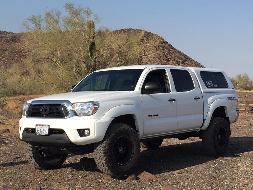

    TTC, If you want 2.5 in the front and 2 in the back I think you would be happy with OME 885's and your Billy's set at 0 and AAL's in the back.
    It will be worth every penny and ride much better than stock.
