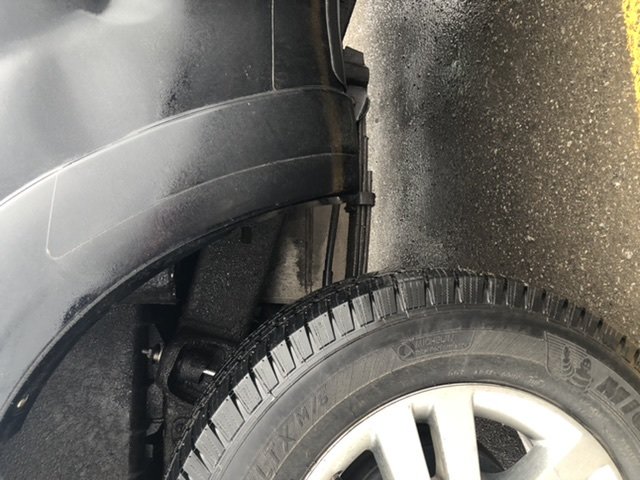

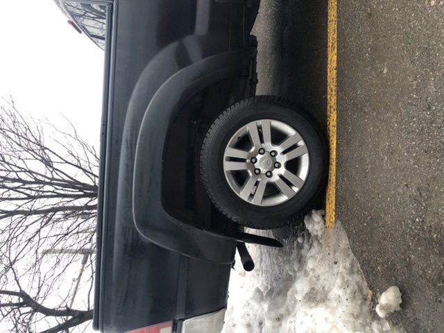

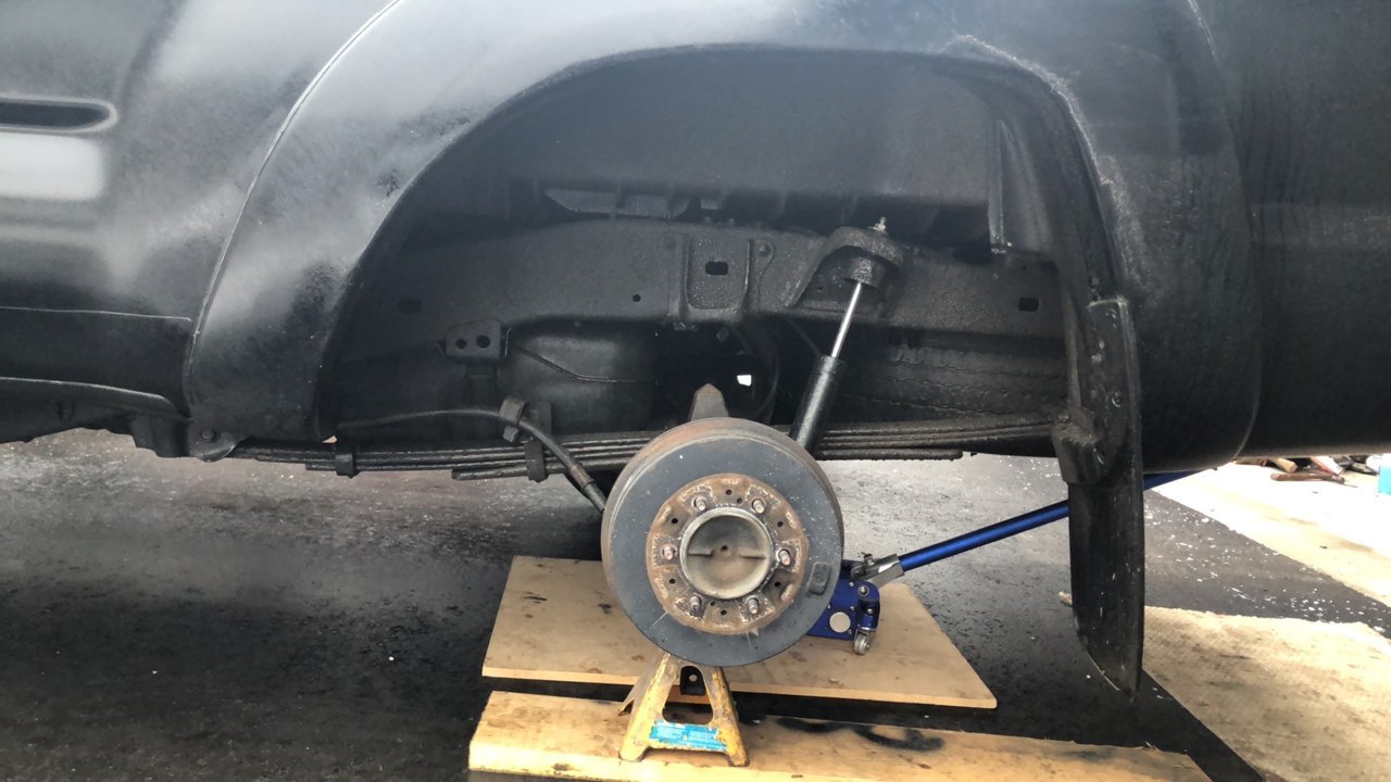

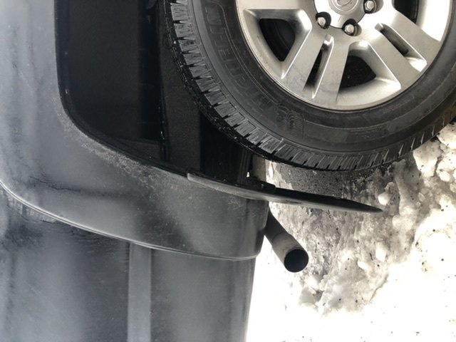

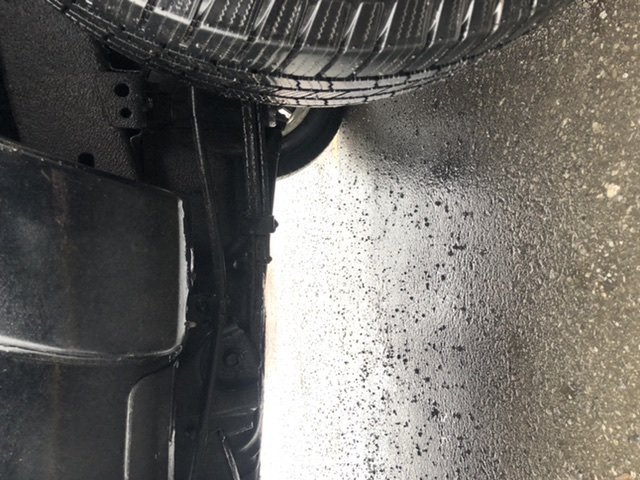

    Well I am at a loss. Put old shocks on and it's still there. Just amplified by the Billy's. Could worn leaves make it bouncy? These shots are with 240lbs of sand in the bed. Should I pop a wheel off?

    Not sure why sideways

    This would be the problem no? That's bad no

    Looks like the leafs are shot to me.

    Yea looks like the truck never had the TSB done. Must have been a different one I looked at. These are original. Im going to order some factory springs from General Spring.
