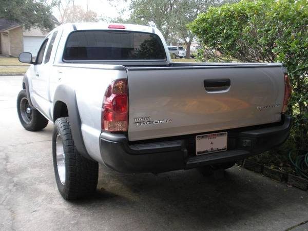

    Alright, here's my before & after:
    Base model tokicos & 3 leaf wussprings.....couldn't find side shot.
    5100s set to 2.5/TRD springs with 1.5 Toytec AAL....

    Thanks for the photos. It definitely helps to get a visual. Based on your last photo, I think the billys set at 1.75 would give it a rake similar to what comes from the factory, just a bit higher.

    I'm thinkin so. Don't let ride quality sway you, 2.5 is not anywhere near harsh on mine at all.

    Thanks Taco...the pictures do help. What size rubbers are you sitting on? How long did you have the AAL when the picture was taken? Does it sag over time?
    STLT, I agree...his front looks pretty level with the back when set at 2.5". I think you'll get a small rake at 1.75". Nothing drastic...similar to stock.
