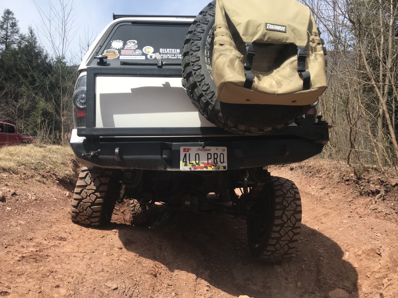

    This is B110 with dakars with AAL. I'm running stock bumps, but extended the strike plate by 1" so I don't bottom out. A simple hockey puck bolted onto it achieves this.
