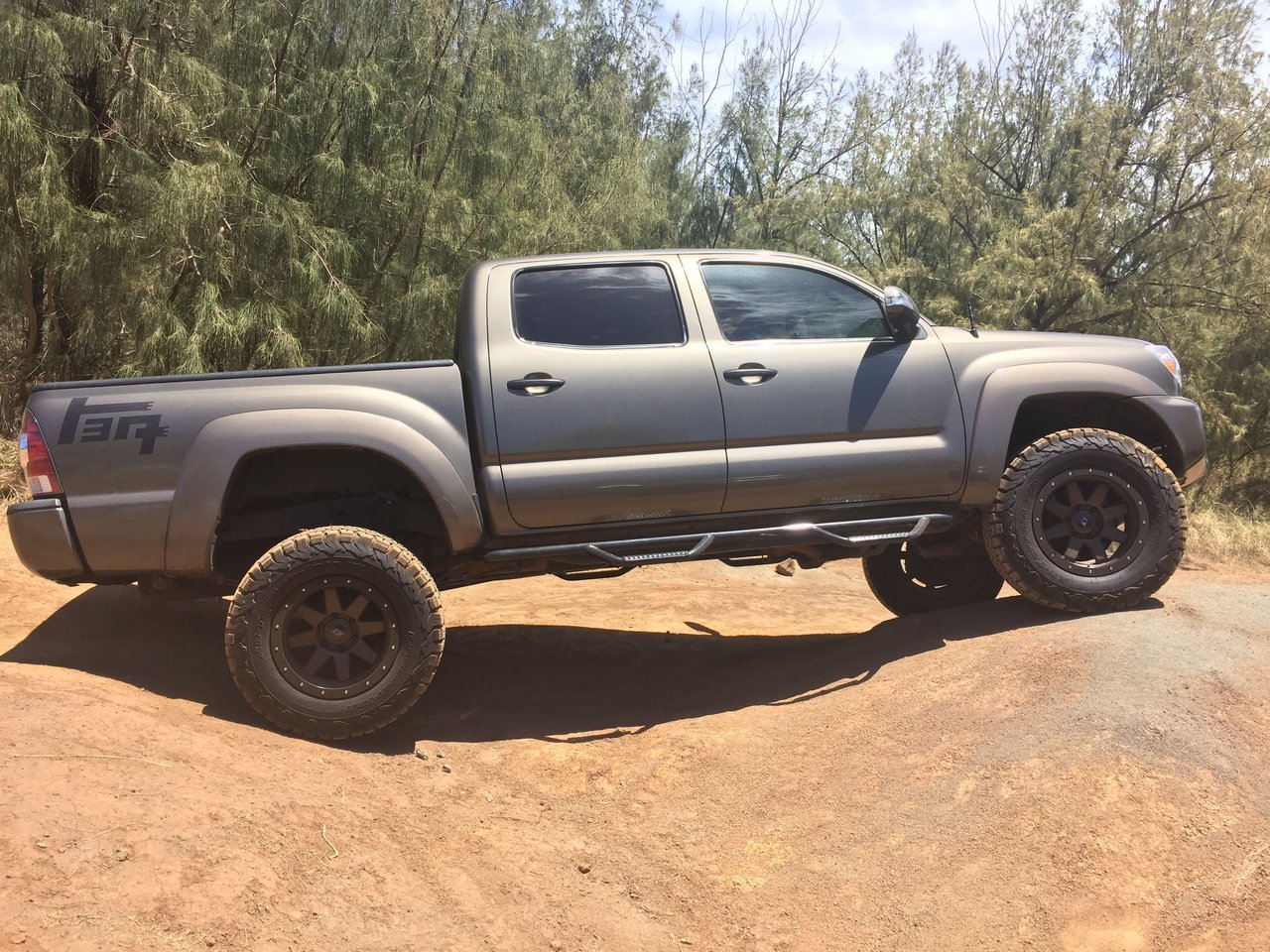

    Performance: K&N cold air intake Flow master Duel exhaust Looks : Wet okole seat covers N-fab side steps 3" lift -bilsteins all around, OME coils, ICON uca, rear add a leaf spring Stealth custom series sr8 wheels wrapped with BFG Ko2 275/70/17
    I suggest u go 6 inches rough country, icon or bds , u want clearance go with those, I’ve been in friends tacoma with 6 inch rough country and there stiff a a mother but great clearance over rocks, plenty of flex too
    I have a 3 inch lift bilstiens all around, icon UCA, OME coils, bf Goodrich ko2 275/70/17, no trimming needed; rubs at full turn when I got people inside in reverse; flexing is ok not as much as u want but better than stock, I went with this set because more covenant for the fam
