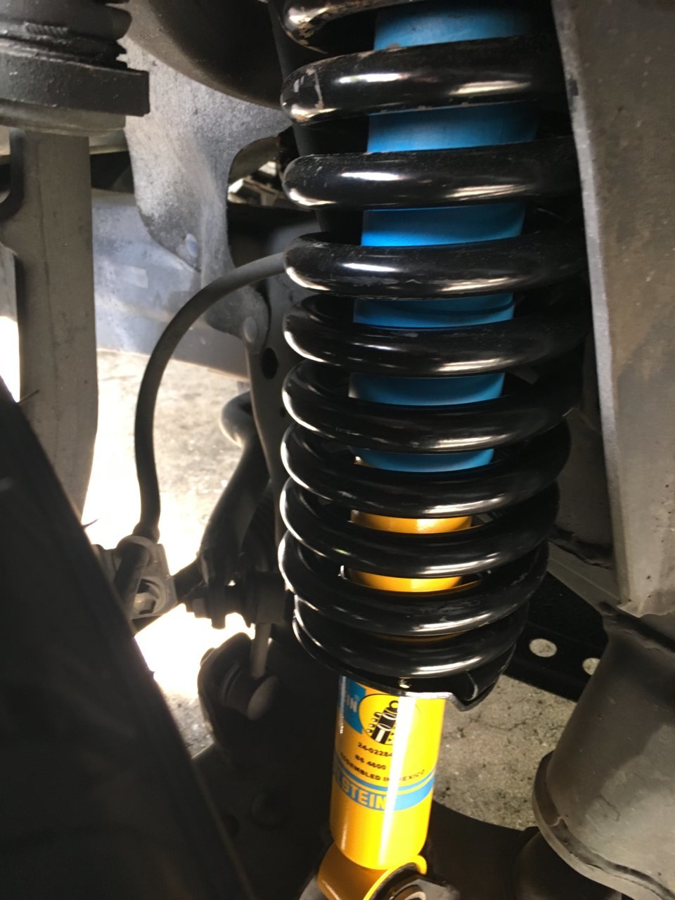

    Bumping this up:
    2002 TRD 3.4 4WD 6 Lug
    I just had a set of 4600s with Moog 81104 coils assembled. I don't want to install these on the truck only to have them wear out prematurely due to incorrect coils.
    Can anyone with experience with or without this same setup provide any input?
    Thanks

    99 PreRunner 4x4 2.7
    That is one beefy looking coil...

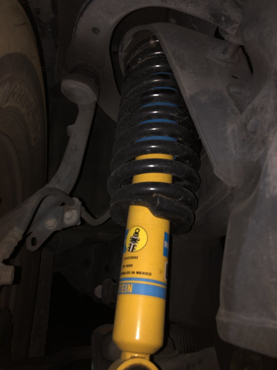

    That was right after I installed them
    This photo is 9 months later
    Looks a little different
