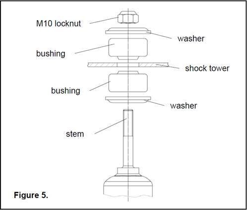

    Changed the oil a few months back and a neighbor commented as he walked past, "Hey you're leaking oil there." Checked, and it turns out thank you to PennDOT the bodies of all the shocks were starting to rot out. The drivers front was the leak. So I bought a set of 4600s from Amazon. When I started taking the old ones out, it looks like there are 2 bushings on the top of the shock sandwiching the spring hat. I only got 2, one for each shock. The old ones are fused to the shock rod, but look like they have one on each side?
    The question is: should I have 2 per shock, one on either side of the hat? I have yet to find a diagram.

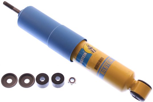

    Your 4600 front kit for a 95 4x4 should have the following for each shock:
    Then be installed with a bushing above and below the shock hat:

    these were under the 95-04 Tacoma section even though they say 4runner. just a basic set of replacement bushings. you may need a top nut to hold it together

    I ended up calling Toyota and ordering all new "cushions" and washers. took about a week longer than it should have, but it handles like a new truck now. I actually scared myself turning left because it actually did, rather than before when it took 3 days for the truck to start turning. It's like it's on rails, comparably.

    i replaced my stock TRD shocks with 4600s a few weeks ago. Neither of the 4 shocks came with bushings or cushions. I recycled the metal pieces but replaced all of the rubber ones. You only need the cushions for front shocks, none in rear. The quote for $153 above sounds rather high; I seem to recall I paid about $60 for the replacement cushions.

    Sorry, you're right; I mis-spoke. The bushings are integrated into the bottom of the rear shocks just like front shocks. But the rear shocks don't have/need cushions like the front shocks. So you only need to buy additional cushions for the front shocks (OP already knows this).
