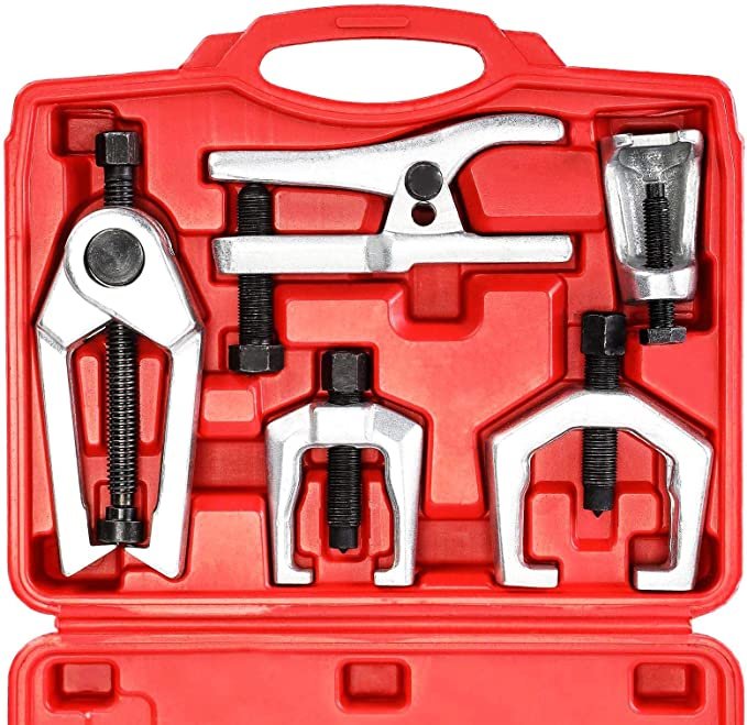

    seemed like a good place to ask... When separating the upper control arm ball joint prior to replacing struts have anyone used a ball joint separator rather than a couple of wacks with a mallet? I have a one of these sets and figure one of the tools would do the job?

    On the first gen 4x4 trucks (1995.5-2004) there is no need to separate the upper ball joint to replace front shocks. Maybe someone who sees this can answer for you, but failing a speedy reply, I suggest asking in the relevant sub forum for your 2015.
