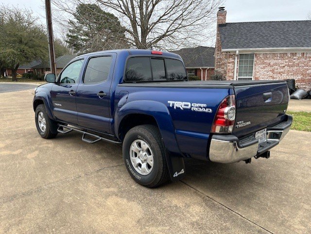

    Returning my 2015 Tacoma to DD status after 5 years being a garage queen (retired and lost my company vehicle). With only 76k miles, I sense the stock Bilsteins getting a bit "loose", especially in the front. Truck is stock with the exception of rear airbags to level under load, even just replaced tires with 265/70-16 Michelin MS2's rather than AT tires (ride is fantastic!). Don't really off road, occasionally tow a bass boat or utility trailer, less than 2500lbs. Question is whether to replace OE shocks with 4600's, or go with the 5100's set on the 2nd notch (.85?). to level the front. Experiences and opinions are welcome! Gratuitous pic:

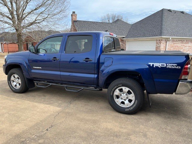

    I ended up going through Suspension Lifts but got the 5100's set on .85. Ride is great, much more controlled than the OE shocks. Don't know what the issue with the photo is, it's definitely not stink buggin' but here's what it looks like now.

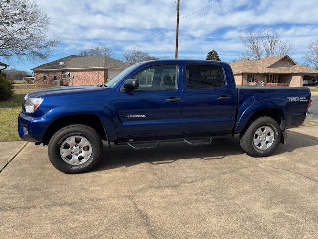

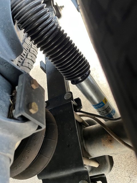

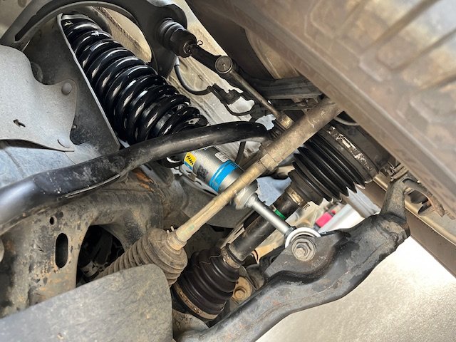

    Some more photos of the finished product:
    Better side photo shows current stance

    Rear shock

    Front shock with new spring assembled at .85
