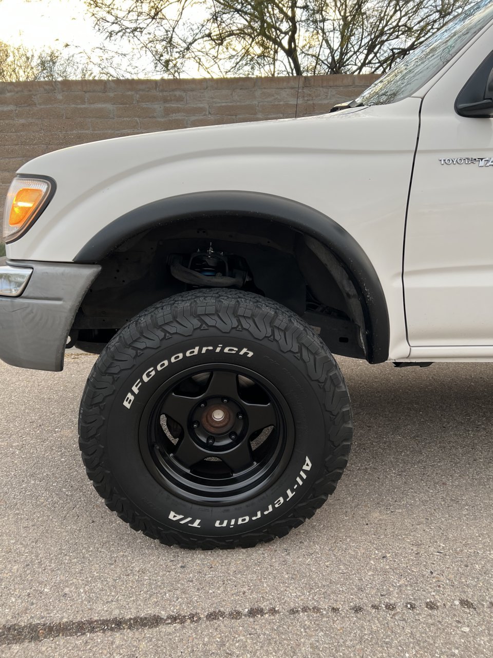

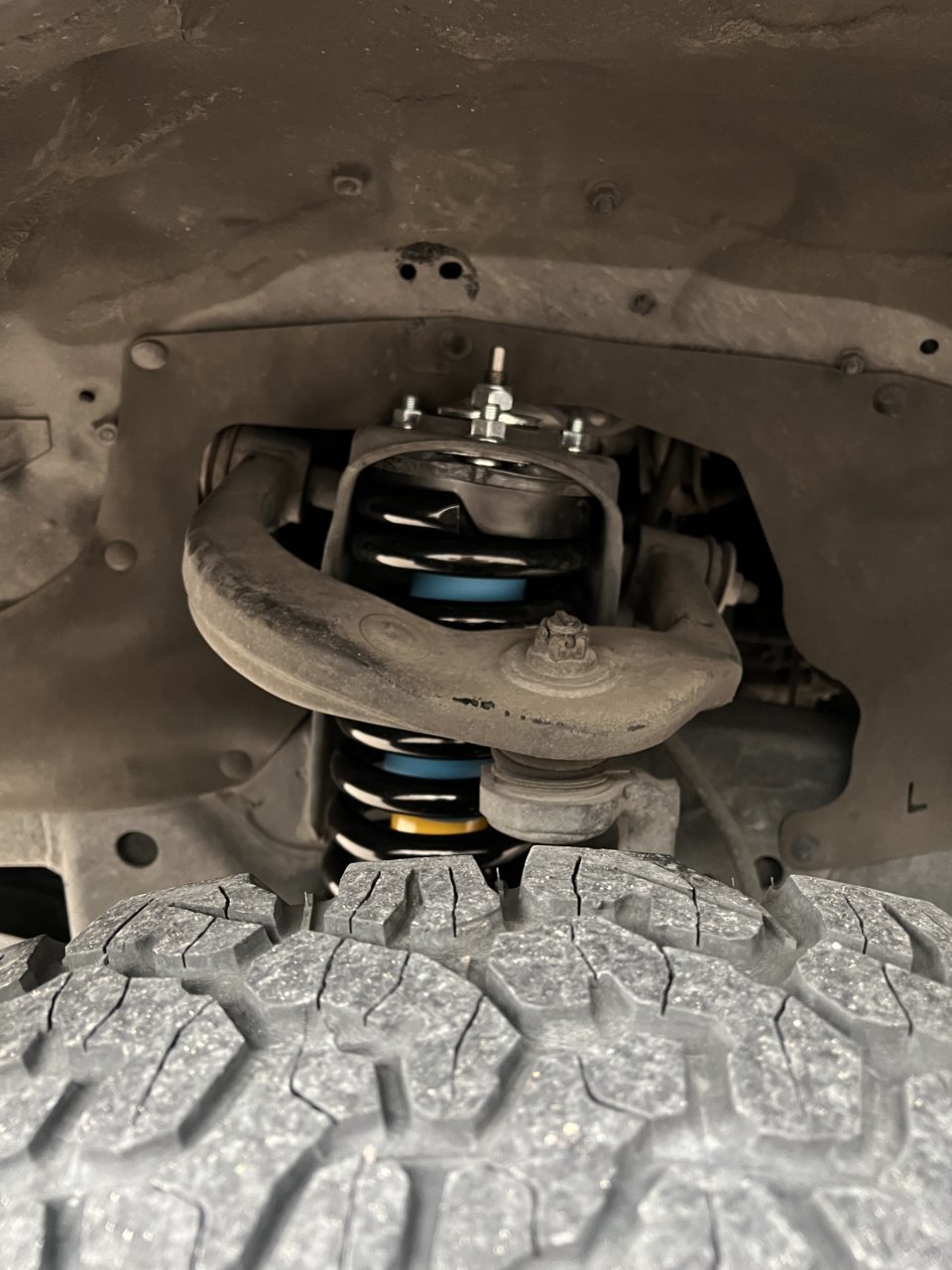

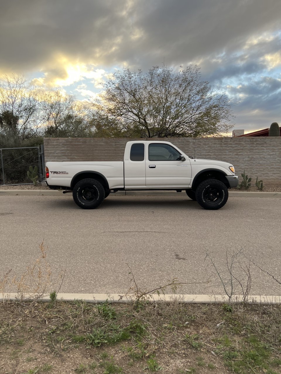

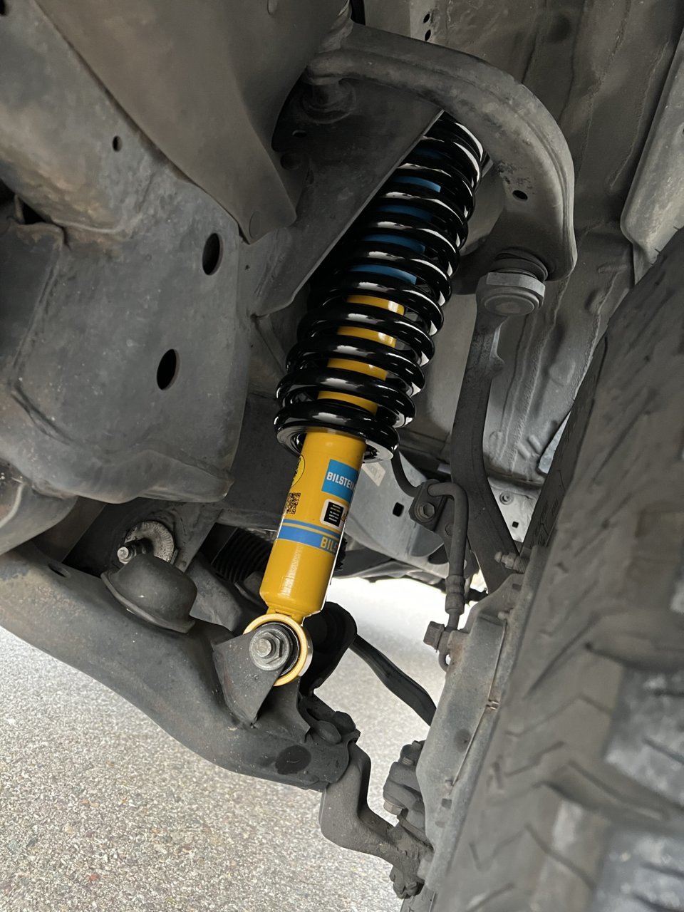

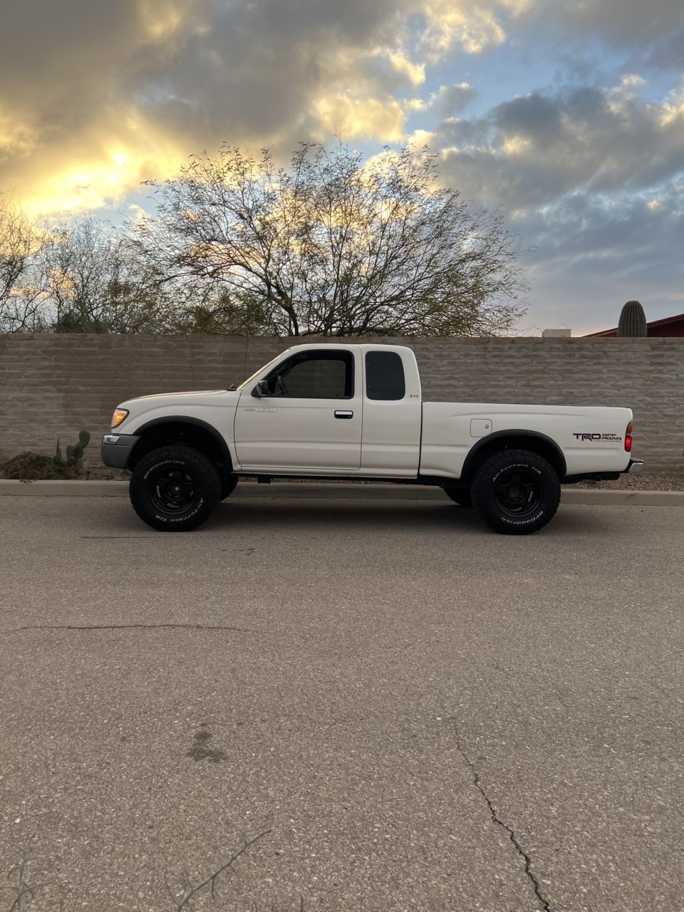

    Some pics of how it sits “leafs are still stock”
    Tires are 265/75/r16
    They looked big at rear hight but now look tiny in the front with the extra height

    I have a hard time believing those are stock height springs.

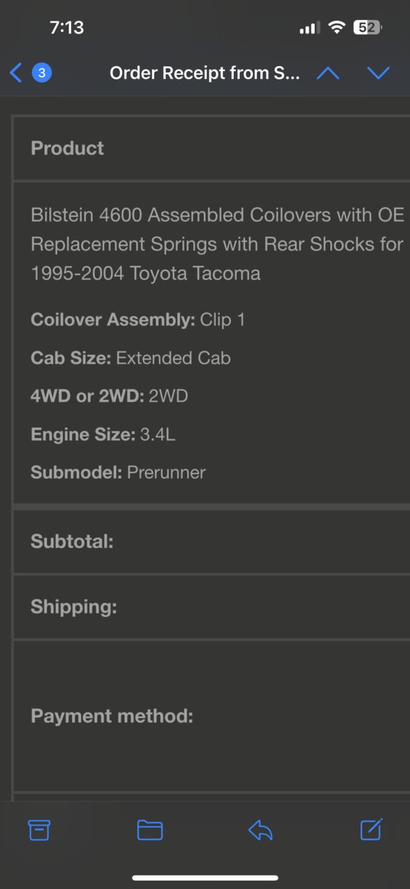

    So this is what I’m wandering, I feel it looks pretty darn high
    Does it matter if I say when I put the old coil overs and new ones side by side they were exactly the same length?
    attached is the options I chose showing OE equipment
