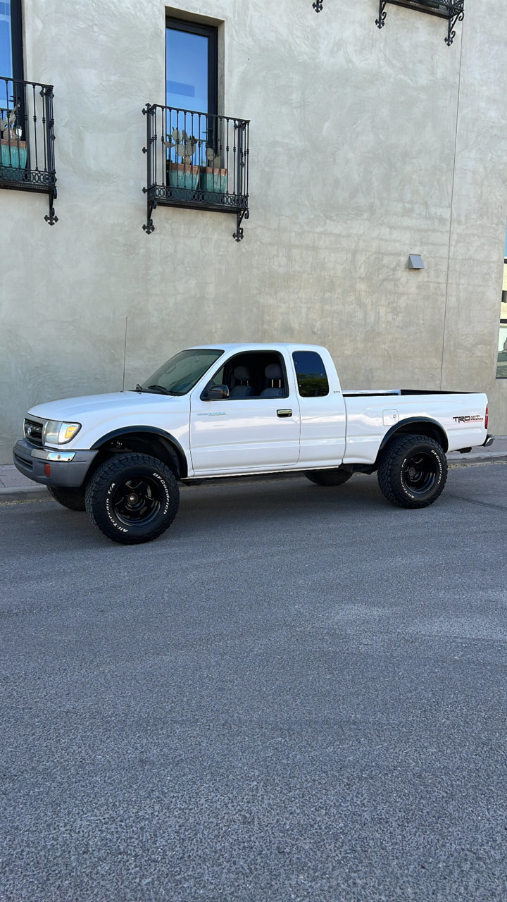

    Ride hight will be determined by the springs that were put on the shocks in the front.
    Here is a picture of how my truck sits now.
    It really hasn’t settled much in a couple thousand miles. At least visually
    The front does sit a little higher than the rear now as my leaf springs haven’t been changed yet but it doesn’t really look too noticeable or bad in my opinion
