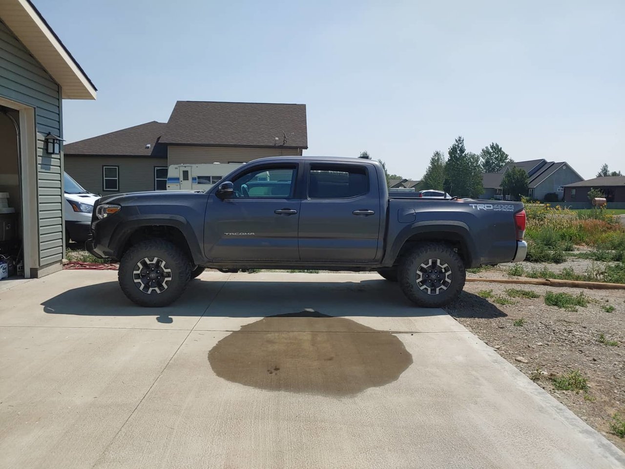

    484
    2019 Tacoma Trd offroad 6MT

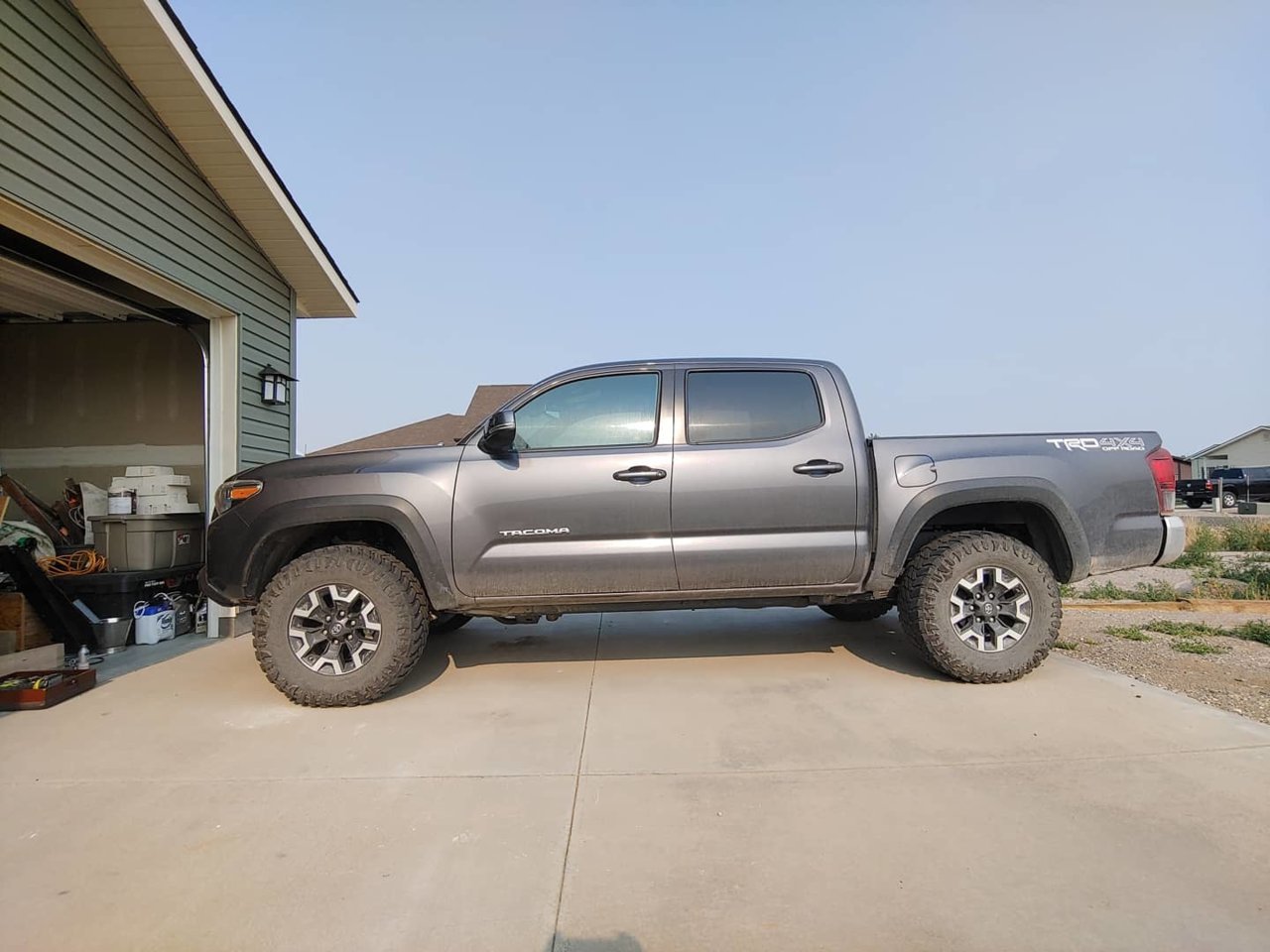

  16. Aug 2, 2021 at 12:55 PM
