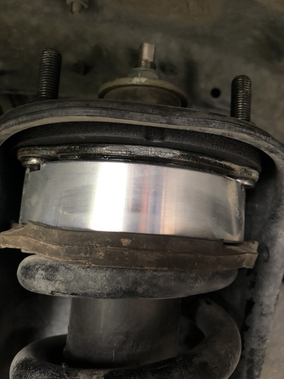

    1DD0DFEC-EAFE-4043-BD81-0A735212A881.jpg How big of a spacer does this look like to you? It’s between .5 and 1”. I either wanna lose this and keep it at the 2.5” setting or drop it to the 2nd or 3rd and keep it for leveling purposes

    That’s is the completely the wrong spacer. Get that thing out of there. That should Have never be used if your are using 5100s especially if you are not using the zero setting on them. You have preloaded the spring by moving the spring perch then preloaded them even more by putting that in. If you had a 4wd shop do that they should have known better. What you wanted was the 1/4” top spacer that sits on top of the coilover.

    That’s what I was thinking. How much lift will I get out of the front if I take the spacer out but KEEP it at the 2.5” setting?

    If that’s a Toytec spacer , it’s either giving 2,2.5 or 3” of lift that’s all they make in that type of spacer.

    You should get 2.5 +\- .

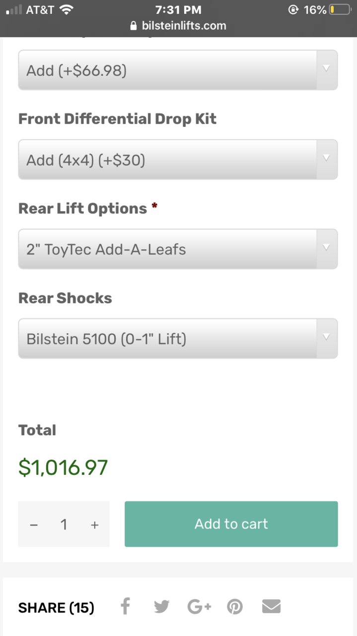

    What lift aal did you install?

    There’s just add-a-leafs on each side of course and 5100 shocks. They’re just AAL’s that came from bilsteins website

    I wasn't aware that was the type of spacer you were running, when you said top-plate I figured maybe a small .25-.5 spacer. I would get that spacer out of there and throw it away, it will only cause you problems in the future.

    If it’s a 1.5-2” aal. You’ll be level or about 1/2” of rake. Just confirm how much lift on bilsteins website.

    84FF788D-5BEC-440C-AE85-D1D58EC396AC.jpg Looks like it’s a 2” AAL.
