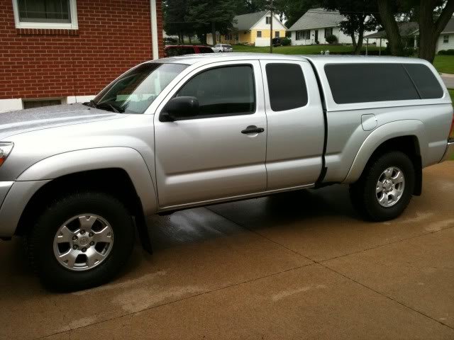

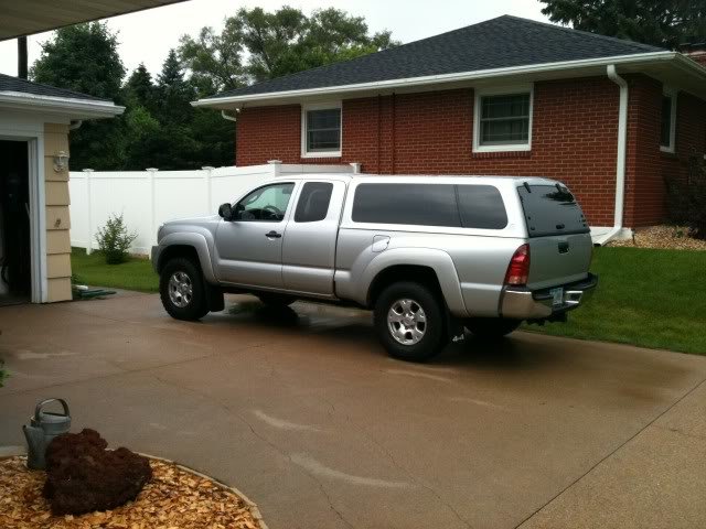

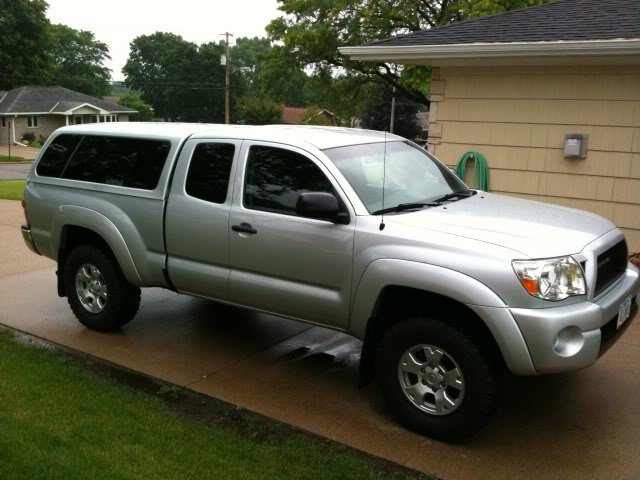

    1.75 and no AAL or TSB. I have toytec's 1.5" AAL but haven't got around to installing them. It sit's about .5" higher in the front. Looks pretty level most of the time, but on a slight incline it does look abit nose high as you can see in the 4th pic

    I'm running this setup right now on my double cab, and mine sits exactly like tacobox's does in his last picture, .5" higher in the front. Like tacobox said, most of the time it looks pretty level, but that's because the space in the wheel well is even in the front and back; when you stand back and look at the whole truck though you can definitely tell it's nose-high.

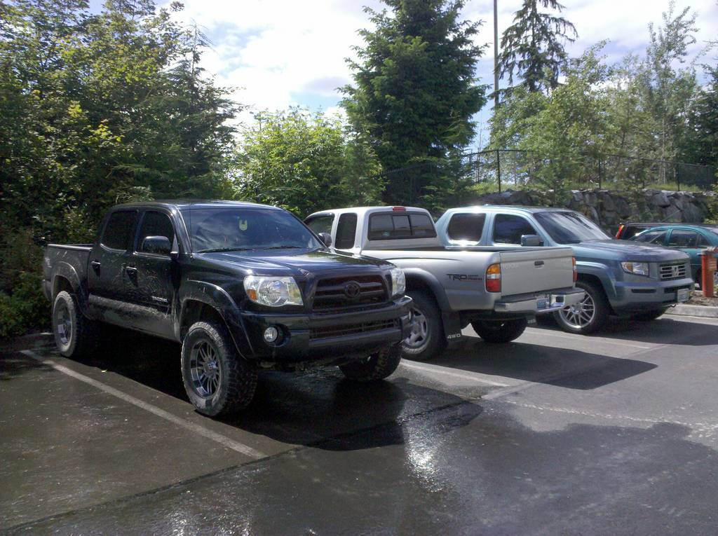

    You can tell a little in this picture that mine sits a little nose high with just the front 5100's and nothing in the back. I plan on doing something to the rear pretty soon though, because I do some towing and hauling and I don't want to be dragging tail all the time:

    They're 285/60/18 on an 18x9, they don't rub at all. They actually didn't rub at all even before I lifted it, with the front mud flaps removed. I'm stepping up to a bigger tire, probably a 285/65/18 in a MT, which should be no problem now that I've got the 5100's set up at 1.75.
