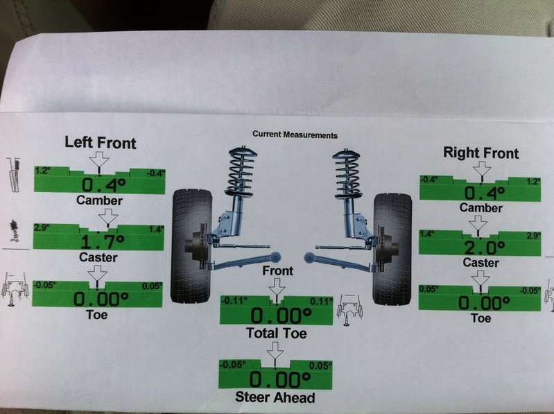

    Had it realigned at a local truck repair and suspension shop, wheels look ALOT better than what the stealership sent me home with but still slightly angled looking, here's the printout 2011 Toyota Tacoma T|X Pro Access Cab with bilstein 5100's on all 4, up front on max setting 2.5" rear 1" riser block, I did not NEED Aftermarket Uca's but would surely look and ride better with them.

    Yup, 2.5" lift with STOCK Ucas

    Looks good for stock UCA's. Now let's see some pics.

    damn i wish i could get it that straight lol. i have a 3" lift with 5100's and 884's front and AAL out back and the fronts look like \_/ with out the UCA's

    Looking pretty good. Glad they tried harder than the first shop.
