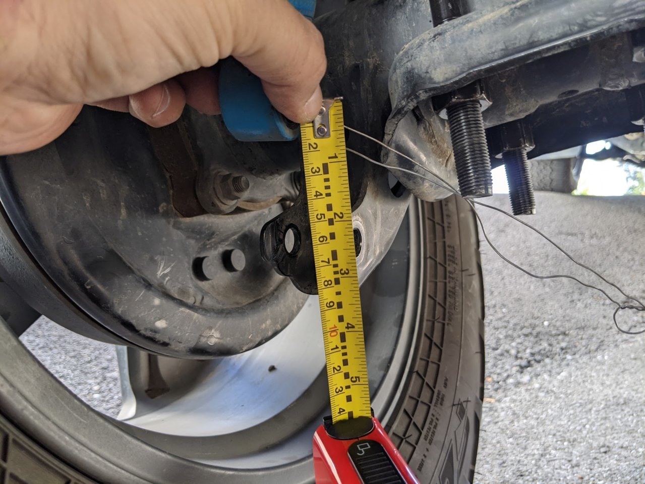

    The Sumos are likely taller than the stock bumps but compress very differently. What I did to confirm was flex out my suspension with the shock disconnected after the RXT (Option 1) were installed. I found 2.75in of travel beyond the stock shocks. A bit of parallax in the pic.
    If you go Option 3 (max lift), you will have a thicker pack to consider in relation to the bumps. With the Sumos, you might be okay, but it is good to check.

    Thanks. I'm assuming that means a bump stop of at least or maybe a bit more than 2.75" is needed to keep from bottoming the shock. The Sumo springs are a lot taller than stock bump but I don't know if they can compress to less than 3".

    Yeah. It is hard to tell. You can flex out your current setup to see how much they compress. You will get more dynamically, but unless you are really running hard and fast, I don't think it would be more than a full flex. Of course, if you are running high speeds in the desert, the 5100s / 5125s might not be the right answer. Haha!
