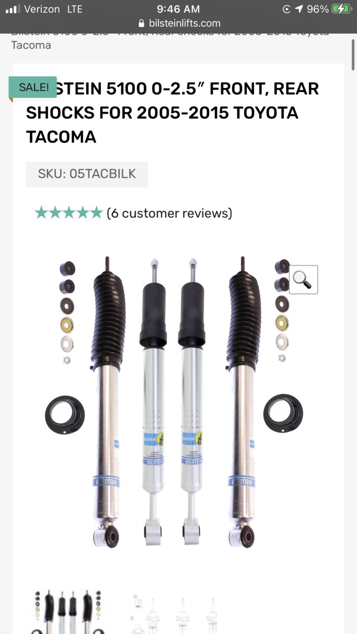

    Hey so for the blistein 5100’s do you need to add a leaf or can you just use the shocks as they come?

    This is the lift kit

    Depending on the front setting you put them at will determine that.

    ^^^ What he said. The front shocks provide lift, the rears do not. So if you want to lift the rear, then yes you will need an AAL, or equivalent.

    The 5100 rear shocks will work with stock height and up to a 1" lift... some say up to 2" just like the OEM shocks. The problem with 2" or greater the 5100 and OEM rear shocks could top out and blow the shock. This is if you're off road and flexing the suspension. Bilstein also makes the 5100 extended rear shocks or travel that are made for 4"+ lifts. Going this route, it's recommended to get taller bump stops to prevent the shock from bottoming out.
    If you are buying the regular 5100 rear shocks you do not need an AAL.

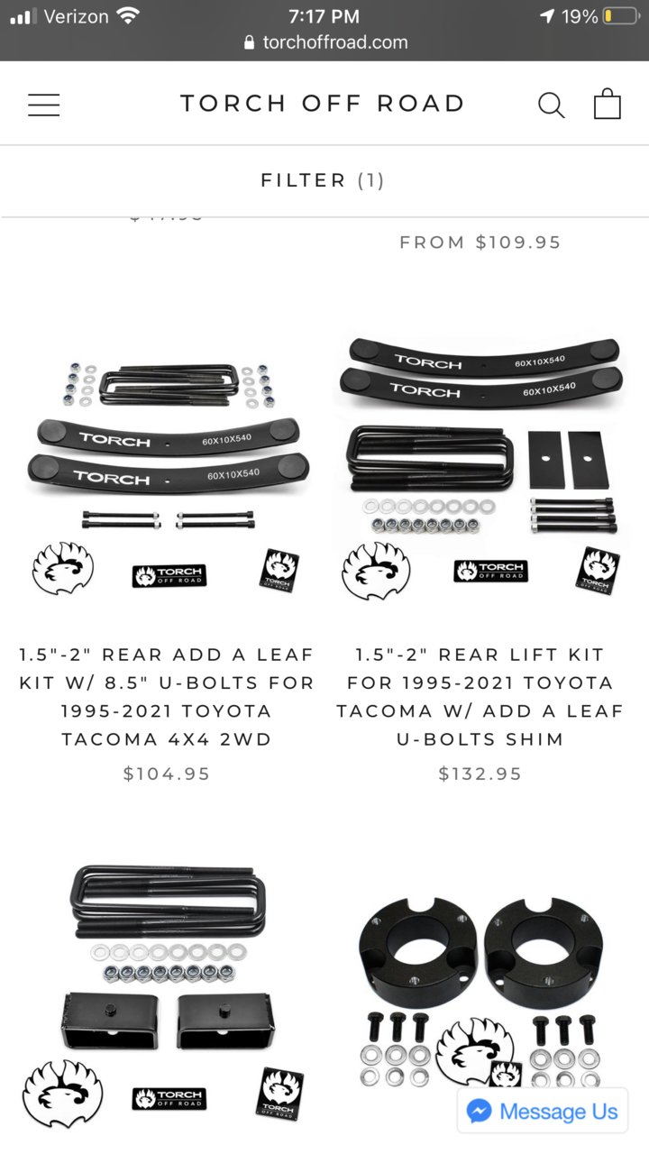

    Gotcha- that's what I figured, just wanted to make sure. ToyTec has a decent AAL and Torch has a AAL that looks the same at a better price. What ever you get make sure they have squeak pads on the ends. I went with ToyTec and had to buy longer u bolts. I got a full 2" with a fresh set of recall leaf packs. The condition of leaf packs on your truck will determine how much lift the AAL will add. Not sure about taller bump stops. I have had Sumo Springs on my truck for a while, which in essence a taller bump stop.
    If you do not already have the extended 5100's, Torch has a rear shock for 2-4" lift for Tacoma trucks.
