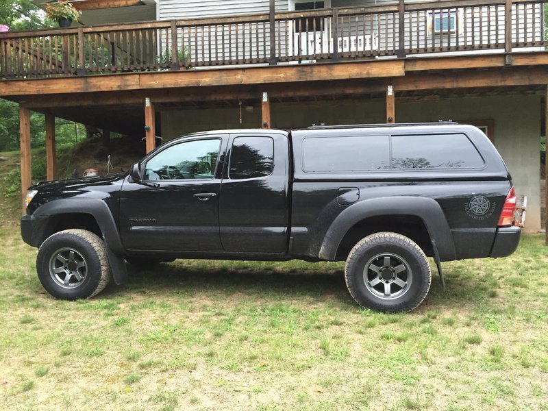

    Access cab with a 2.7 motor, 265/70/16 tiresIMG_0466.jpgome884,s

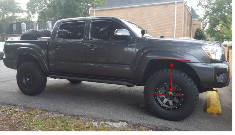

    It's because there is no exact answer! It varies per vehicle. Your best bet is to measure from the hub to fender all around, and the difference is your rake. There's your answer.

    i'll put a tape on her when i get home and see if i can figure it out or post my measurements and see if you can help :)

    Ahaha glad I can help. Do you at least understand where to measure from? Hub to fender is the most accurate way to know a difference.

    Damn, I was just drawing a pic myself! My lines are a lot smaller though :anonymous:
