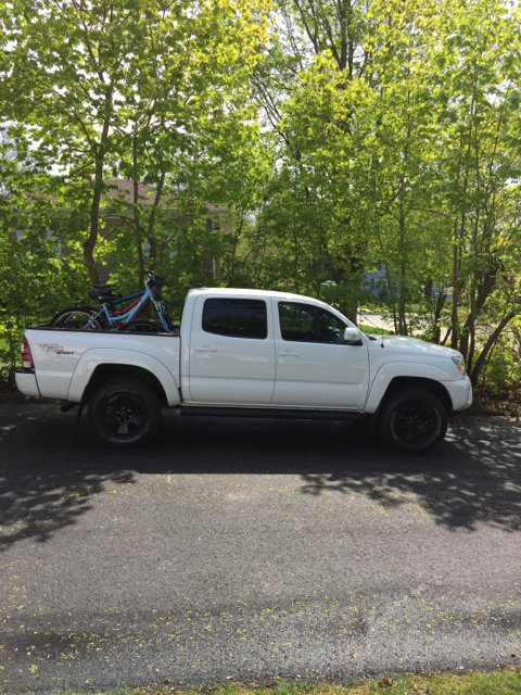

    #24
    Rsoxfan1
    Rsoxfan1 Well-Known Member
    Mar 23, 2012
    #75442
    821
    Mass
    2012 DCSB TRD Sport 4x4
    f7fcc7629cd338e1bbb47b2c36459d6c_def76dec0d7bb061ad8cc696158cb54530cd5cb3.jpg4cda1e6911cc56fb0b70e274cb33b2b3_b7a1de06999f5c5b303ec394bb79a4c8c5300f1a.jpg
    I've had mine about a year. Set at .85 with the 4 leaf in the rear. It still retains some rake. 1st pic is with virtually no weight in the back. 2nd pick has about 500lbs in the back.
