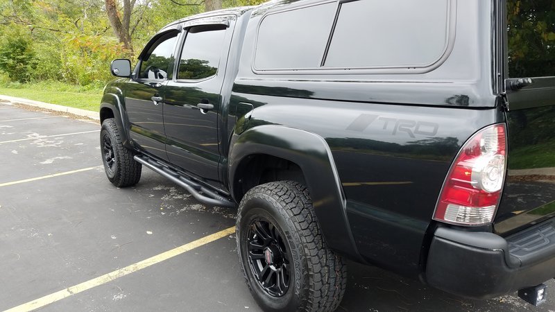

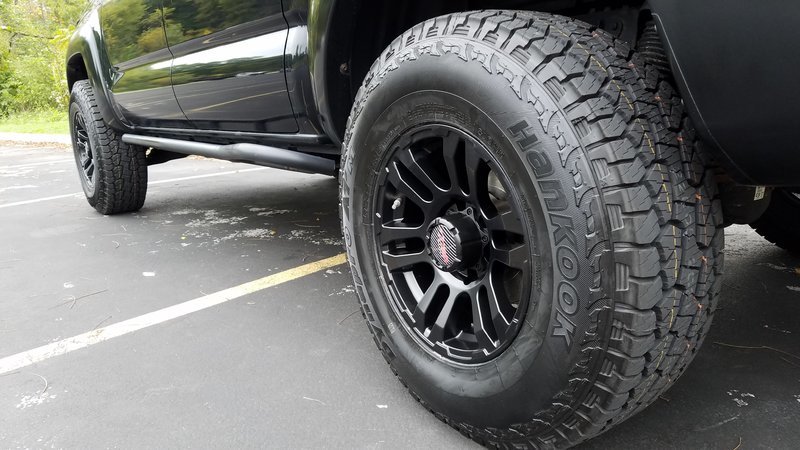

    I have an 09. 5100's all around. Fronts set at zero with Eibach springs which give 1.6" of lift. General Spring HD leaf packs in the rear for 2" of lift. Maintain the 2 " rake front to back.
    Hankook AT-M Dynapro 265/75/R16 tires.
    No issues and no rubbing.
