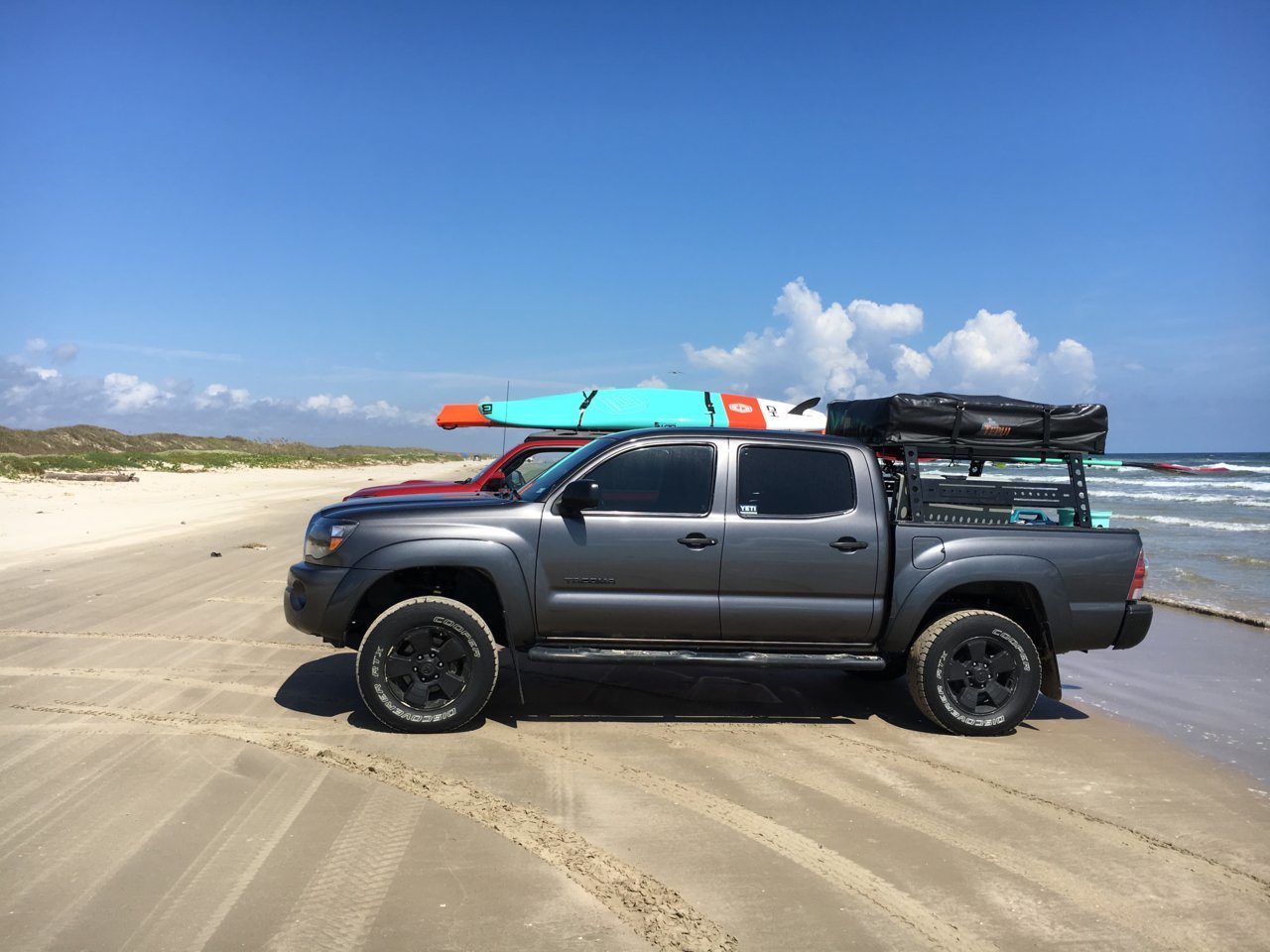

    I appreciate your response. Gave me the answer I needed. I had been looking at a 255/75 R17 and other sizes right around the 265/70 R17.
    What make/model of tire are you running in the picture? I like 'em.
    EatSleepTacos[QUOTED] likes this.

    I’m glad I was able to get you the answer you needed! Those are cooper MTP in 295/70r17
    Griffin13[QUOTED][OP] likes this.

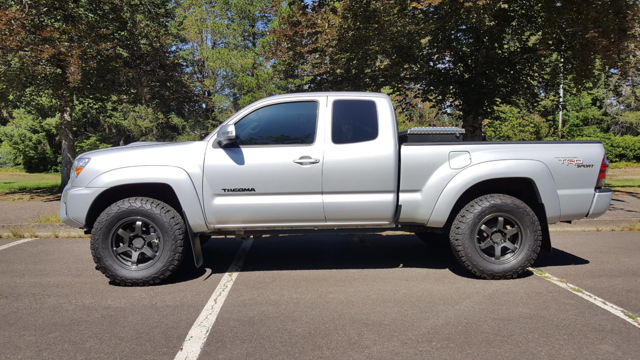

    Here is a picture of my old wheels and tires before and after my lift was installed. 265/70/17. No rubbing. No Rubber prior to lift either.
