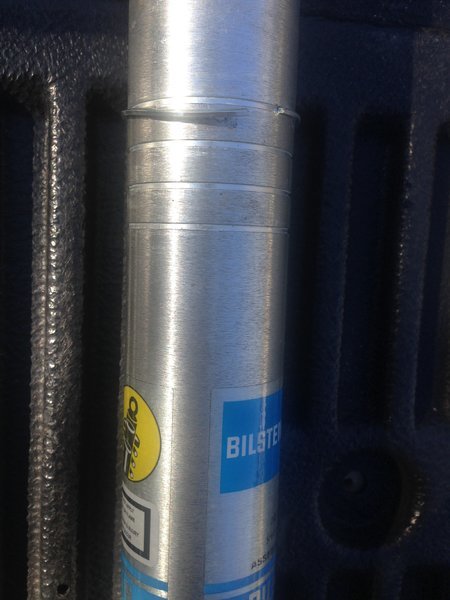

    Well I just got down to taking my shock apart and would you look at that......

    The seat is also scarred to hell as well.....i think they owe me a new strut.....

    They are closed until Monday, but they will definitely be getting a visit from me..... I am beyond pissed now, seeing the bent snap ring....
