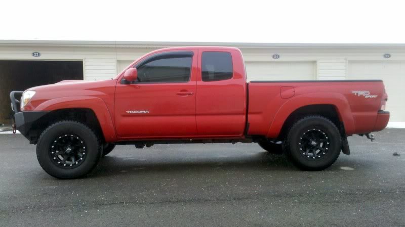

    17x9's with 265/70's and 5100's set at 1.75

    Thank you KPT, and kessler that is the exact set up i want. Are the 5100s the only thing you did to your suspension? Are the billys all the way around? Do you like the ride with that set up? Did you have any problems getting the wheels and tires on there, spacers, ext.. ?

    I did all four billies, and the rears improved my ride quite a bit. I'm glad I did it. I have the TSB rear which is 1".
