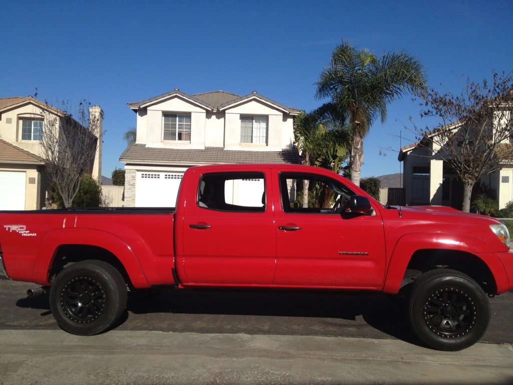

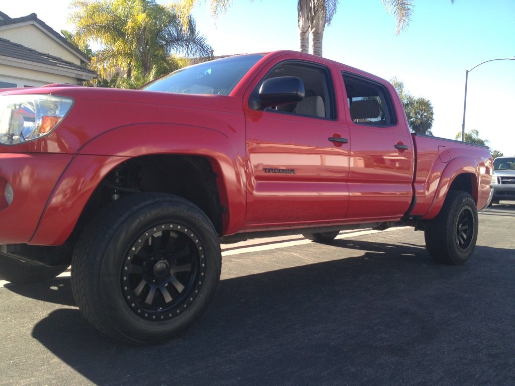

    Hi guys I just wanted to post that I readjusted my bilstein shocks from the 1.75 setting to the 2.5. My truck looked level at the 1.75 setting but I wanted it a little bit nose high. At the 2.5 setting they are not too hard. They seem to be the same stiffness as before. Here's a pic [​IMG]

    Looks great! Im installing mine this weekend and was planning on setting it to 1.75

    Looks good

    looks good
    congrats on having the impossibly elusive double cab long bed TRD offroad :cool:

    Do you have a TSB or any type of rear lift? Also what size are your tires?

    i dont have a rear lift just the stock 3 leaf pack. and my truck is an sr5. i just bought it used and it came with trd decals haha i never took them off. tires are 265 65 17. im getting 285's in the next couple weeks

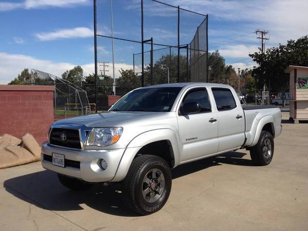

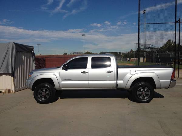

    I have the Bilsteins set at 2.5". Its somewhat rough. Its a simple, fairly cheap lift to level your truck but they aren't the best ride. When you go over speed bumps and such, you can really feel a jarring feeling coming from the coil overs. On the freeway in some spots, it gets pretty bumpy and you can really feel the stiffness. I would like a smoother ride, so I will probably upgrade to the Fox 2.0's when i get the money to. Im also considering setting them back down to 1.75" for the time being because I cannot get the alignment right with them at 2.5" with stock UCA's. So I am debating on keeping them set at 2.5" and getting some UCA's, or just saving money for now and lowering them to 1.75". I am also curious to see what my truck will look like at 1.75", because right now it sits a little nose high.

    Lols I didn't catch that. I was too focused on the bird dookie.
