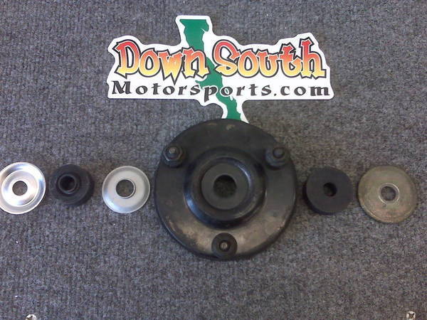

    Since I didn't see the disassembly of the old struts, I am unsure of the order / position of the bushings and the rubber top perch. Anyone have some guidance / Diagram for this?
    Does It go something like this?
    (PIC ATTACHED)
    EDIT: After more searching, found a picture from a use.
    Says it goes in this order LEFT ---> RIGHT = BOTTOM ---> TOP
    Hope this helps others!

    This is a common problem.
    People either forget to install a steel washer on the shaft that goes below the top plate
    OR
    People decide not to use the black plastic dust boot that goes over the shock shaft. This boot has a small metal spacer in it. If you don't want to use the boot that's fine, but you need to use the metal spacer that is inside the plastic.
