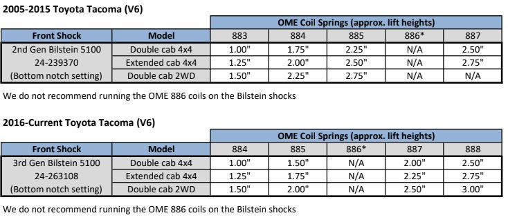

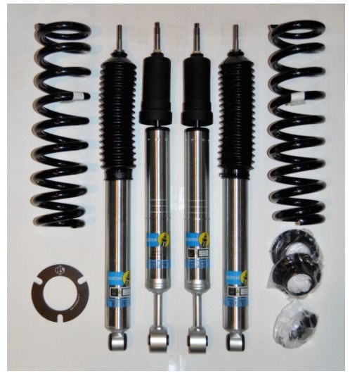

    I went with 883 at 0 with OME coils.
    PERFECT RIDE, LEVEL, UP AN INCH. VERY COMFY!
    Here's the guide I got from Head Strong.
    https://www.headstrongoffroad.com/store/p440/OME_Coil/Bilstein_5100_Kit_-_(HS05BK-1).html#
    FYI I had all of this installed for free labor at the dealer when I got the frame replaced (free do to rust). They said they had to take it all off anyhow and would rather put on new.
