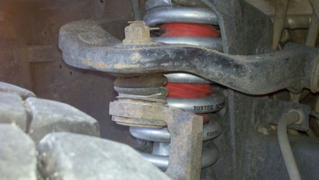

    Hey guys got my 5100's in yesterday. But i was wondering if this is an issue. The lower seat where the coil sits is pretty jammed. I know on these, they are suppose to be loose and not welded into place.
    i tried loosing it up with my hands but i couldn't. I'm pretty sure that it will come loose with a good whack with a mallet. but i wouldn't want to warp the seat...
    any thoughts?
    also are you guys sing dust boots on your fronts? are they needed.
    Thanks
    Ruben

    take a rubber mallet and give it a good whack, it should come loose. it looks like it just slid down crooked and jammed itself.

    ^X2
    Give it a good wack! Mine came the same way. Oh and make sure you put that lock ring on the bottem slot

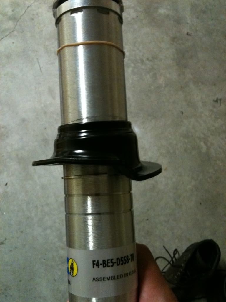

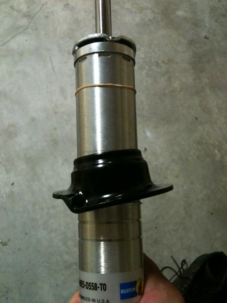

    When i installed mine, i forgot to put the boot on the one side. So i put one the other side to see if it would do anything.
    You mounted the cylinder up or down. Your suppos to put the shock facing down with the cylinder at the top

    lol they are upside down then. Think of it like this, why would you put the part that holds all the oil closer to rocks?? haha
