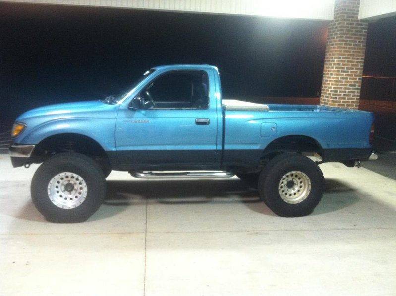

    Got the lift on!

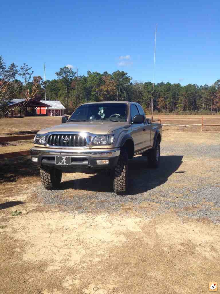

    5uqyveny_5232df1d0b44d3e0f669299e9e5b18fd74aecc36.jpg my billies and eibachs! With a 2" AAL in the back.
