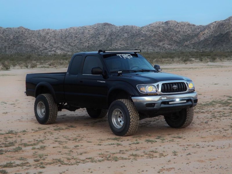

    Ok looked through quite a few (awesome) pages here, but not nearly all of them... I have an 01 prerunner v6 ext cab with a spacer lift that was there when I bought it. Looking to upgrade! Didnt know much but learned a lot today reading here.
    I found the ajustable coilover kit
    http://toyteclifts.3dcartstores.com/Ultimate-Tacoma-lift-with-Bilstein-shocks_p_394.html
    And am REALLY loving it. I want (and probly need) new leafs in the back but can do w/o for now. So I was thinking of this kit with the silver 600lb coils, (no diff drop obviously), and 2" shackles (as I dont ever haul any loads or anything so no point in aal's). Then the dakars later on down the road. Came out to $968 w/TW discount (sweet discount btw). Whatdya think?
    Oh and would I need anything else like shackle bushings or maybe a brake relocating bracket? I have an issue with my brake line being arched over the leafs causing my ebrake light to come on or flash on bumps so I'm guessing the previous owner skipped that part. But I would think I would be ok if I removed the lift blocks and the leafs set back to normal position against axle yeah?
    Attached a couple pics how she sits now with the spacer/block lift (dont want y'all thinking its a 'proper' lift, heh). Think its a 2.5" not sure tho.
    EDIT: After reviewing some of the previous pages there was someone who was also interested in this kit but they said theirs came out to $700 something. And was unsure why the cost difference of the basic kits or make your own kit. This kit is for FULLY adjustable coilovers pre-assembled and ready to go. And I looked closer at the description and looks like it comes with the Brake Proportioning Valve Bracket Kit. Not sure tho as it only shows the "BPV-K" under the description at bottom. I'll have to call. But I'm unsure how the other guy got a much lower price. But hell even for what I came up with, it seems worth it to me. Versus the racing coilovers (which no one should need unless they acutally race or do serious offroading). But anyways, just my ramblings of a newb.
    Let me know what you guys think. I really dont mind the price tag if you think its too much. But I want to make sure I cant get a little more savings:D
