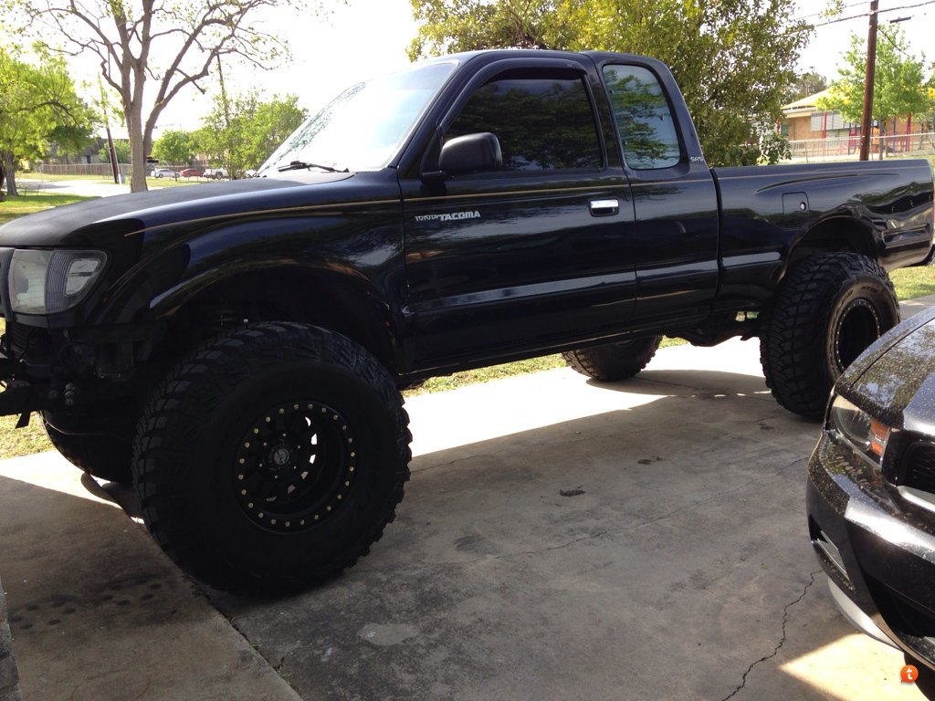

    tc98tacoma
    tc98tacoma Well-Known Member
    Nov 5, 2010
    #45752
    4,217
    Nik
    San Antonio, Texas
    98tacoma4x4
    3inch toytec coils 5100's, aal(soon to be replaced), 33/12.5 km2s, + a money hole...
    heqebu6a_8268a198290c9e8e9c203adbfb8ea372e0d27f03.jpgyde5ezur_0bda6950d56390c8b68d0d29e6c9cd9572f4e1dc.jpg
    Bilstein and eibachs have served me well
