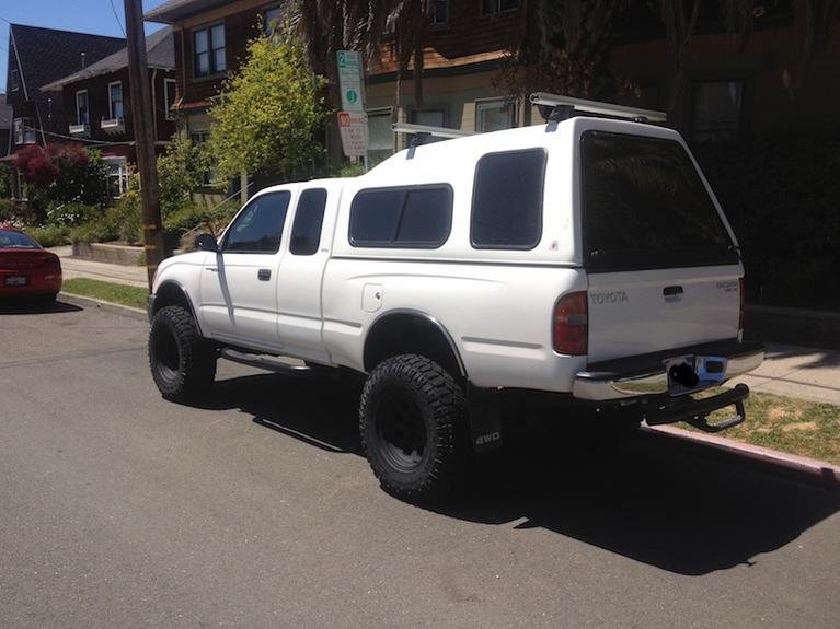

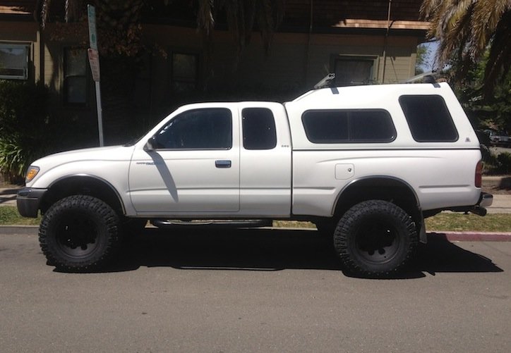

    Finished this last week. Eibach/5100's in front. Dakars, AAL, small block, and 5125's in Back.
    Wrangler Duratracs 285/75/16.
    Next up are bumpers and some sliders, so I can drop the side steps.

    Looks awesome!
    So for the rear you have the dakars + D6XL + block?
    Curious why you needed the block? How much weight other than the shell?

    Well, I was told to and bought an axle relocation plate, as the Dakars sometimes shift the axle forward. It's 3/8" thick. I put it all together with the plate and when I set the truck down, the axle was too far back. But I liked the rake it had and didn't want to lose it. So I took out the plate and added a centered one instead. The Dakars and the D6xl just didn't give enough lift by themselves.
    The shell and a tool box are the only daily supplies. But I load up to go camping, and I don't like sagginess. I like my truck like I like my women:
    face down, a$$ up.:D
