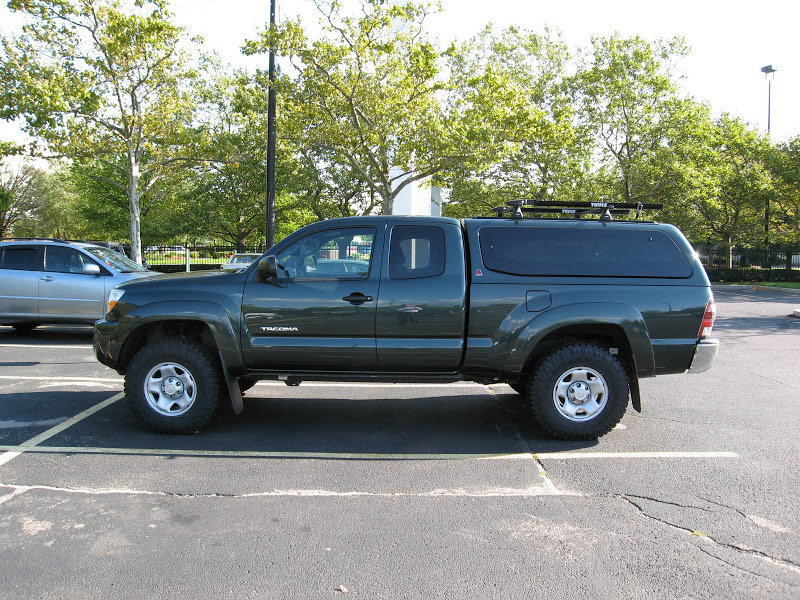

    Here is how she sits now. I think I am going to live with it for a little while, then probably add in the rear from Toytec to bring it back to the stance that I am looking for.

    i think it looks fine:thumbsup:.

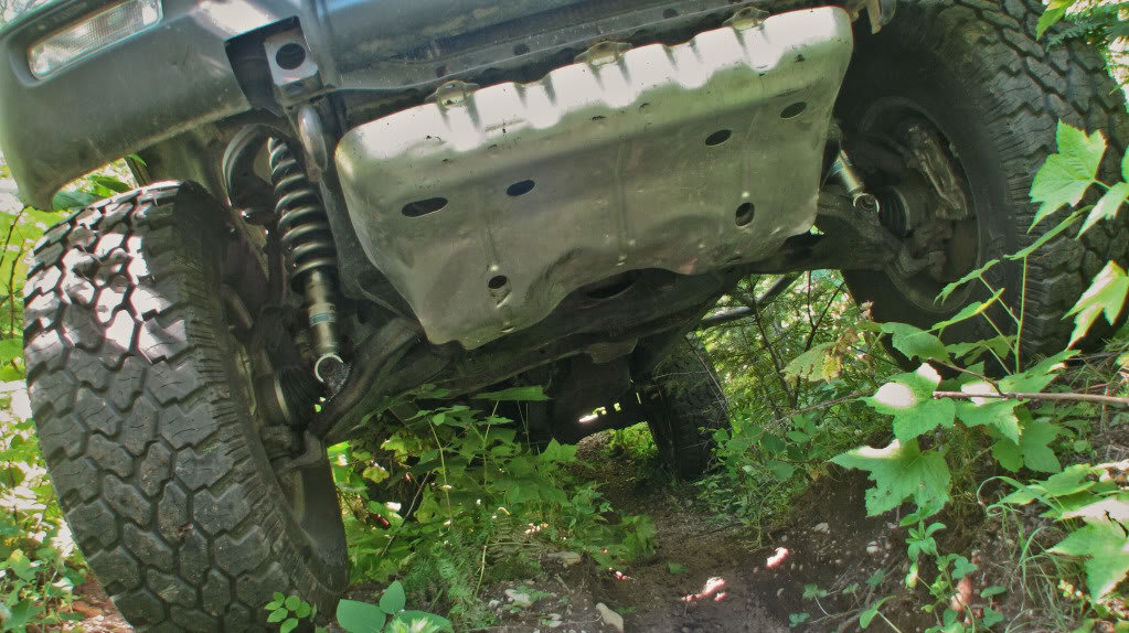

    You can get a complete plug and play 5100/Eibach and bushings from Toytec. They charge extra for putting it together though. I know you can get the top plate from Toyota, but i dont know where else.
    Eibach Pic!
