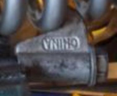

    Those bolts are just smiling. Not very often they get to touch eibachs.

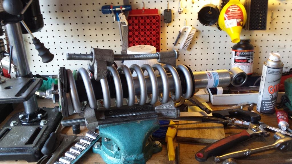

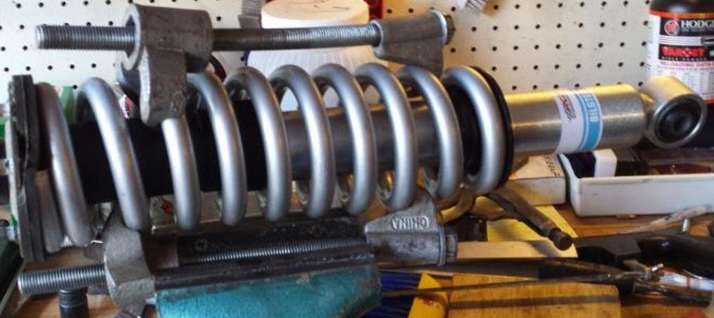

    I'm going with this. :D
    I tightened everything using the 1/2" ratchet in the picture. Things were getting pretty tight when I got it compressed enough to assemble everything. The second one I disassembled the compressor and then inserted the bolt when I had the finger things as far apart as possible. The bolts on the compressor looked a little better than this one. And plenty lube on the bolts. ;)

    Ha yeah I used a set of these for mine too. I was sooo ready to get that top nut on and those death traps off

    I took mine to the tire shop to have them swap coils. It was worth the 20 bucks
