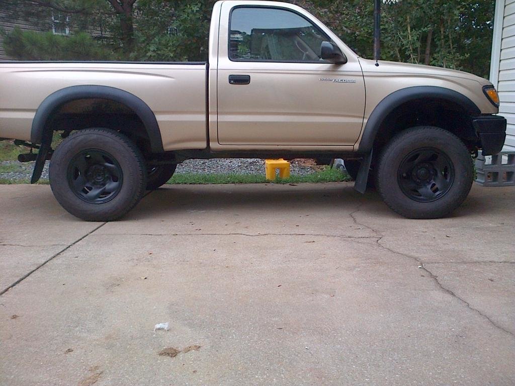

    2002 with 5100s up front on stock coil. Fabtech AAL in back. Plastidip on the stock steel rims. Duplicolor paint on the faded flares and front bumper. Got 2.5" all around.

    Front end is stiffer but it isn't noticeable due to the rear end beating me to death with the AALs. I didn't change the rear shocks due to budget constraints at the moment but I don't know if that will ease my stiff back end performance.

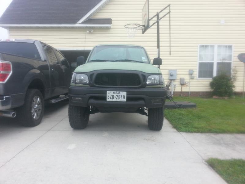

    Put the lift on about six months ago and now I have a lean to the drivers side and I don't go wheelin.
    1/2" difference
    Any ideas guys?!?!

    I just installed my lift and I have the Same thing. I think they call it taco lean. I could be wrong. I think OME sells some sort of trim packer to install above the drivers side coil over to fix it, I'm not terribly bothered by it so I'll probably leave it.
    I'm not positive on any of this, I just remember hearing this somewhere

    Just talked to Toytec, they said it is typical for our Tacos with afetr market shox and I just need a 1/4" spacer.
